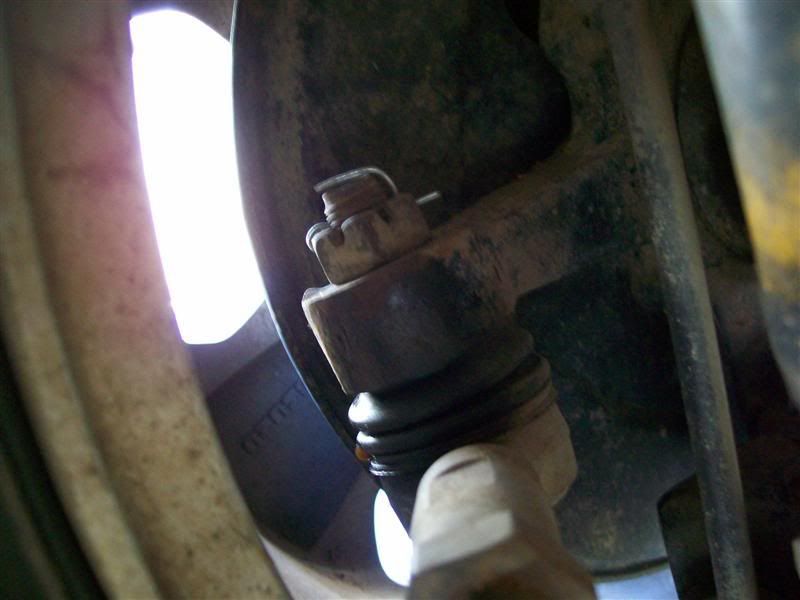

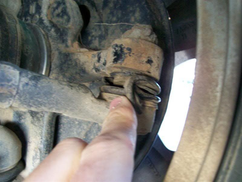

ah the clunk, such a reassuring sound, have a look at your tie rod ends,
do they look like this?
1st looks fine doesn't it?
....on closer inspection....i think the term is..."as dry as a nun's ...."
drivers side is still wet but leaking non-the-less
in mine you can feel the clunk in the footwell, and i know that to be it
hump the sides of your car... got a squeek?
next, those plastic wheel well guards, rubbing on the bumper? i cut mine down because they were grinding on the bullbar making it squeek
#15 ·
this just solved my problem with the clunking Im having when offroading in my rodeo. I need to call up matt and get some new boots for my driver side tie rods. Mine seem to like to clunk when in 4 low going up hills. If Im wrong correct me please. Also, my cv boots on the outside on both sides are torn right now.
