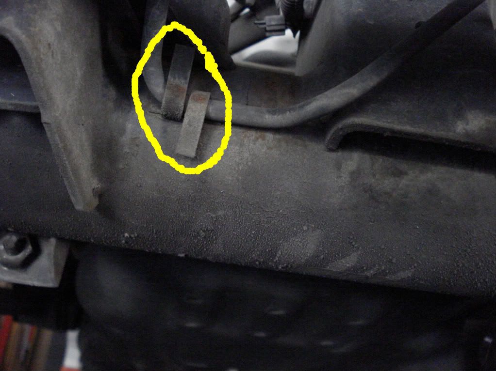

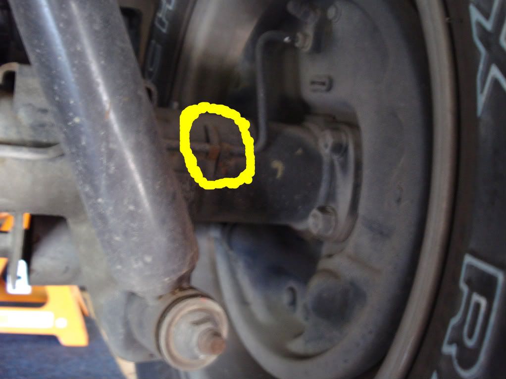

first jack up the rodeo. does not have to be too high my tires were about an inch off the ground.

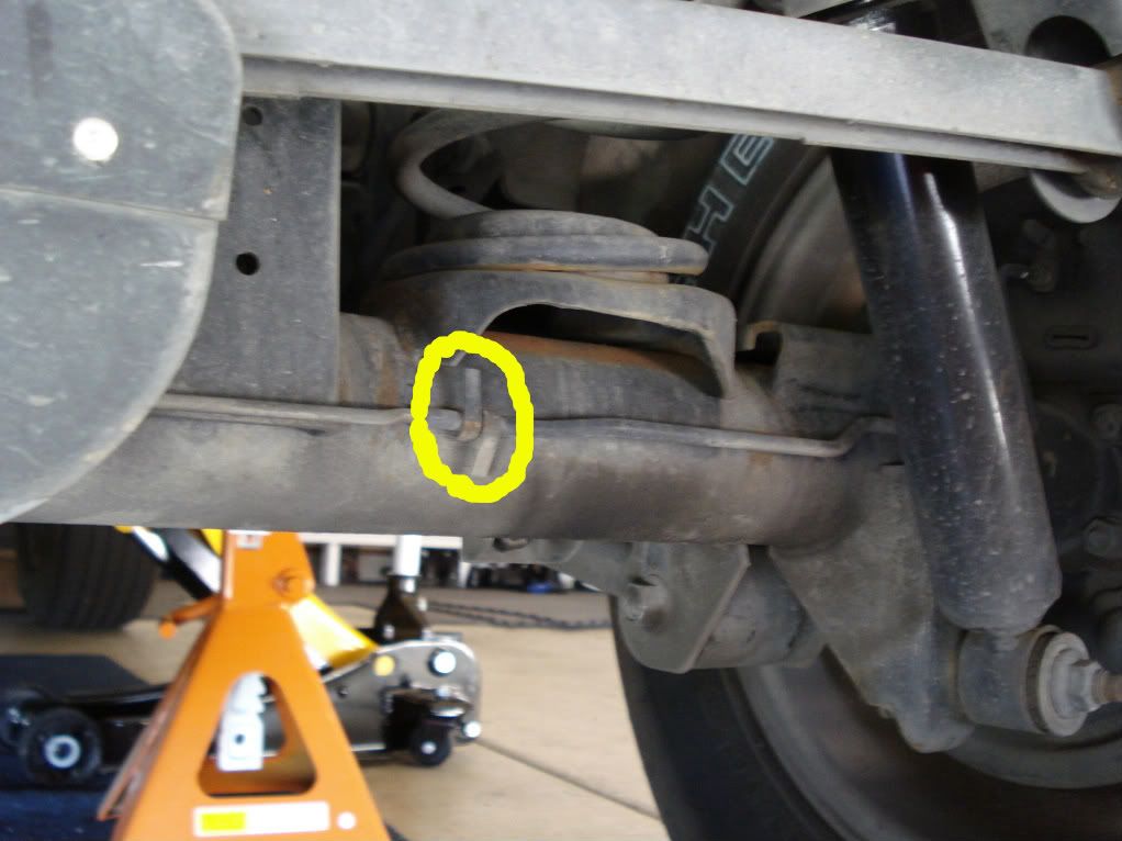

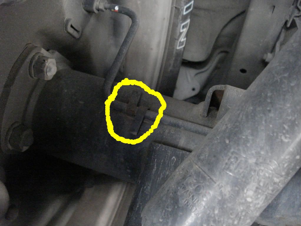

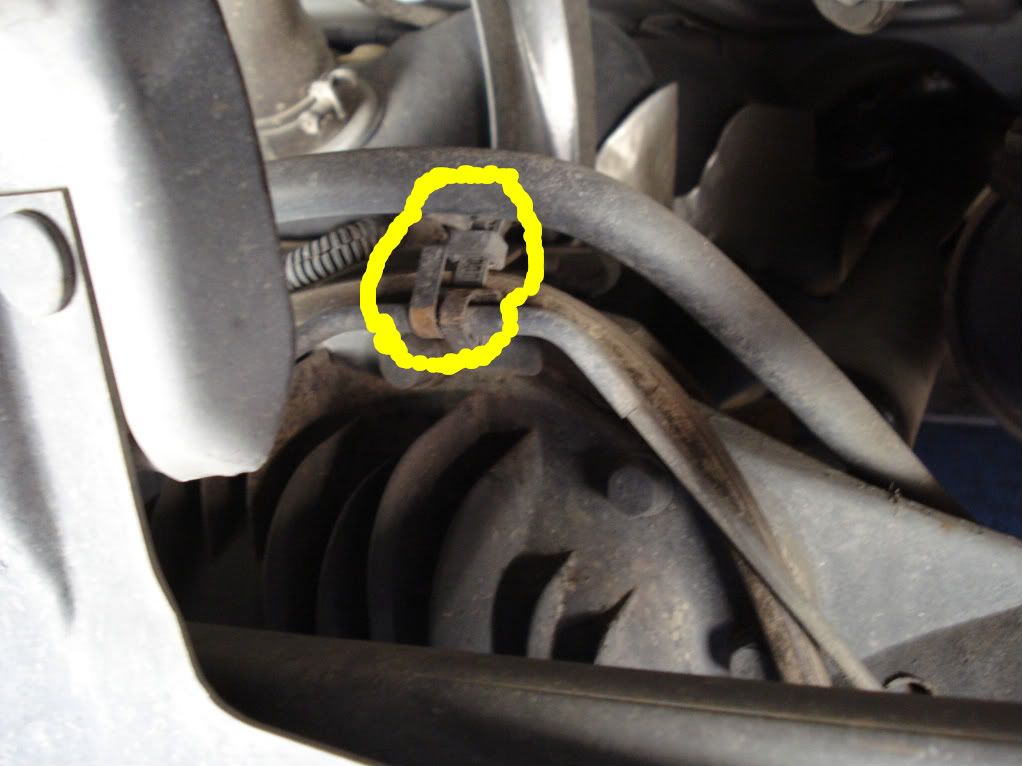

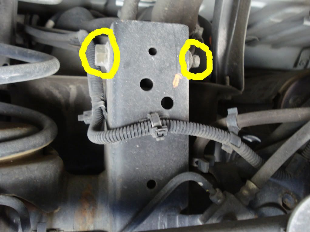

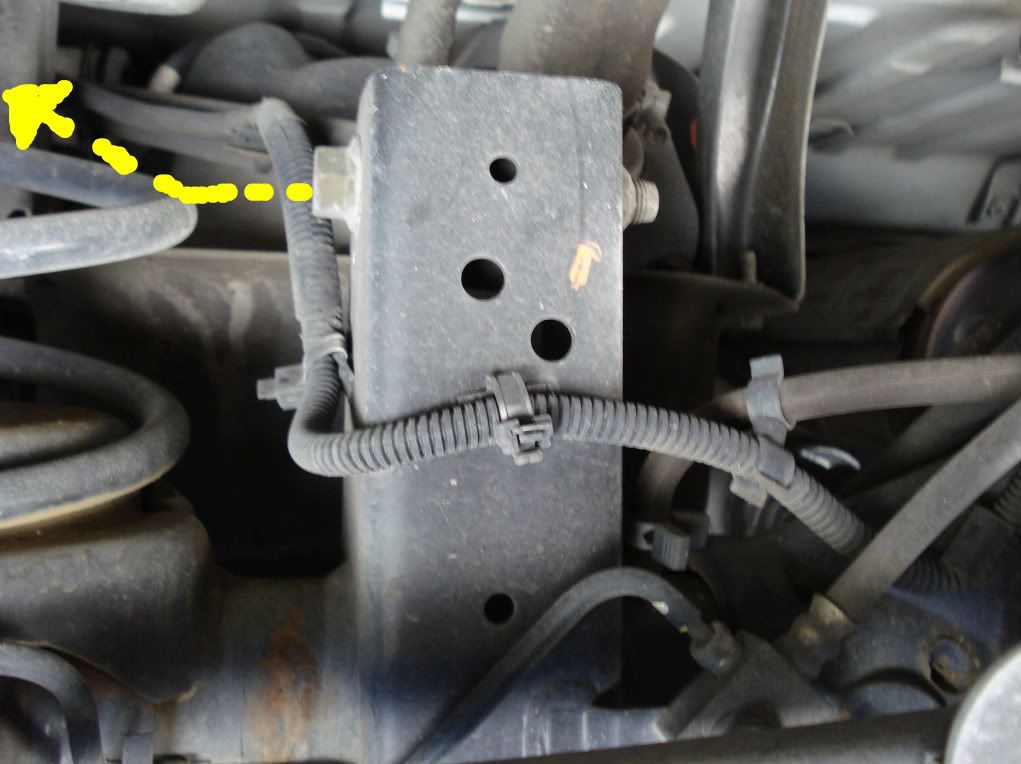

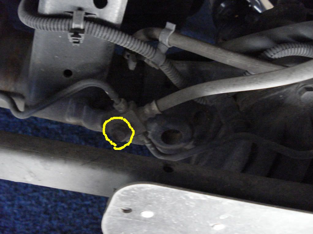

after taking off the tires support the diff with a jack. and unclamp the brake hose and unscrew the brake connector from the rear axle.
left side:
middle:
right side:

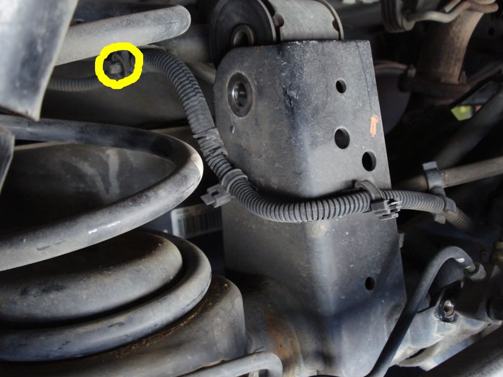

also there is a wrapped wire that is ziptied to the upper link so just pinch the bottom and the wire will let loose. (the pic is it already detached though)

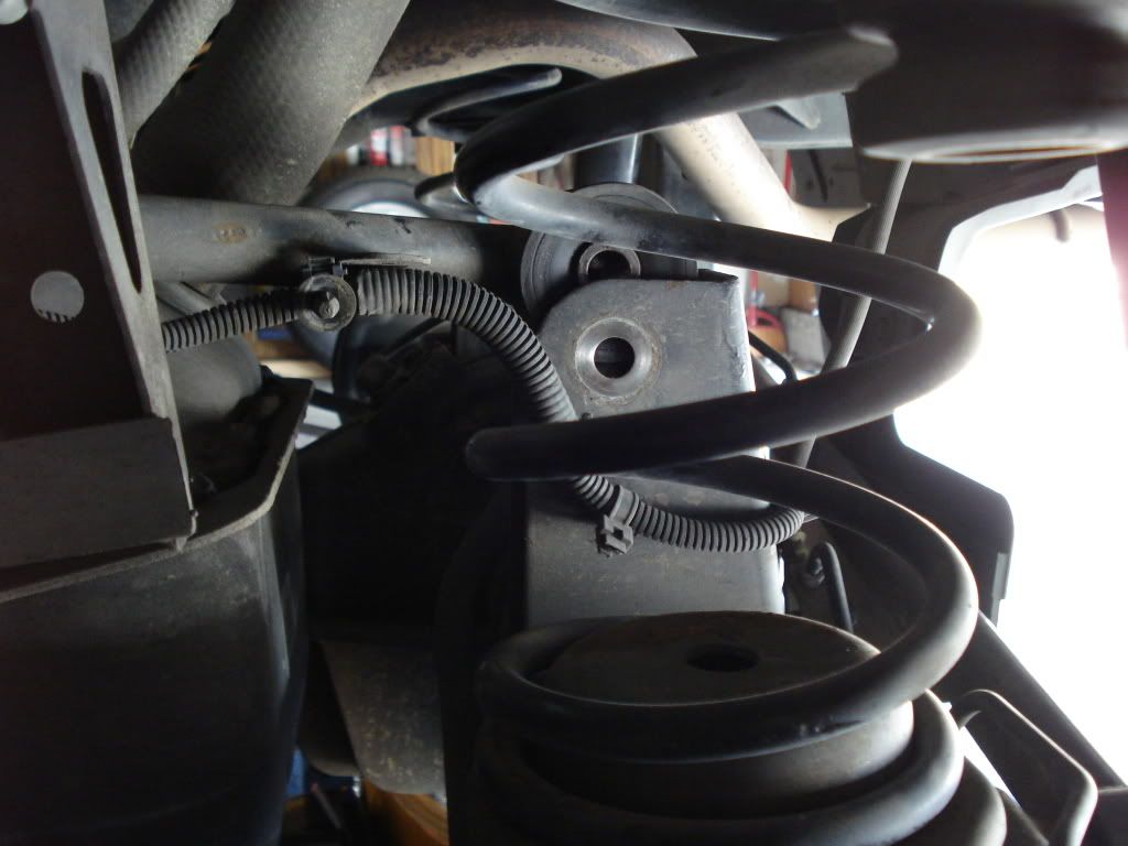

next remove upper link bolt on LEFT side ONLY. it may look like the spring is in the way but try to jack up or down the diff to give the best clearance. you may want to use wd40 on the nut because i needed a breaker bar just to loosen it up. after you take the nut off use a screw driver and hammer to push the bolt out and it will just slide over the spring with ease.

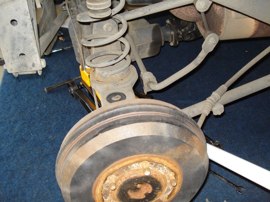

then lower the diff slowly until the springs are loose like this.. (be careful and watch the brake lines and all wires so they don't extend too far)

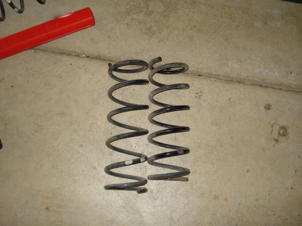

here is the springs side by side (trooper left - rodeo right) my springs came off of a 2002 trooper.
then switch the springs and start reversing the steps.
NOTE: with the trooper coils the upper link bolt hole was not blocked anymore by the spring. this was the hardest part for me though because the holes did not line up perfectly and the bolt wouldnt go through the other side because of it unaligning when you put one side on (hope that dosent sound confusing). you may want to have a thrid hand around because i had to wedge and pull while a thrid hand tapped the bolt through.

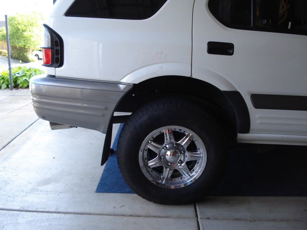

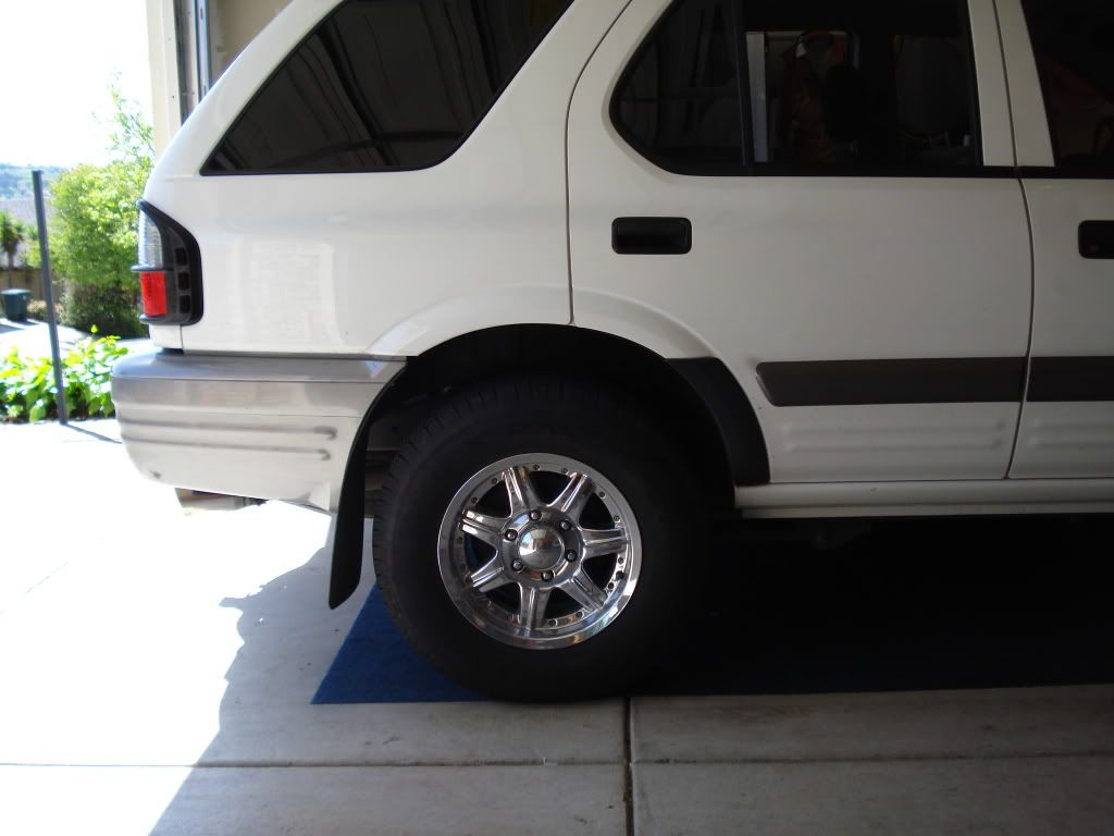

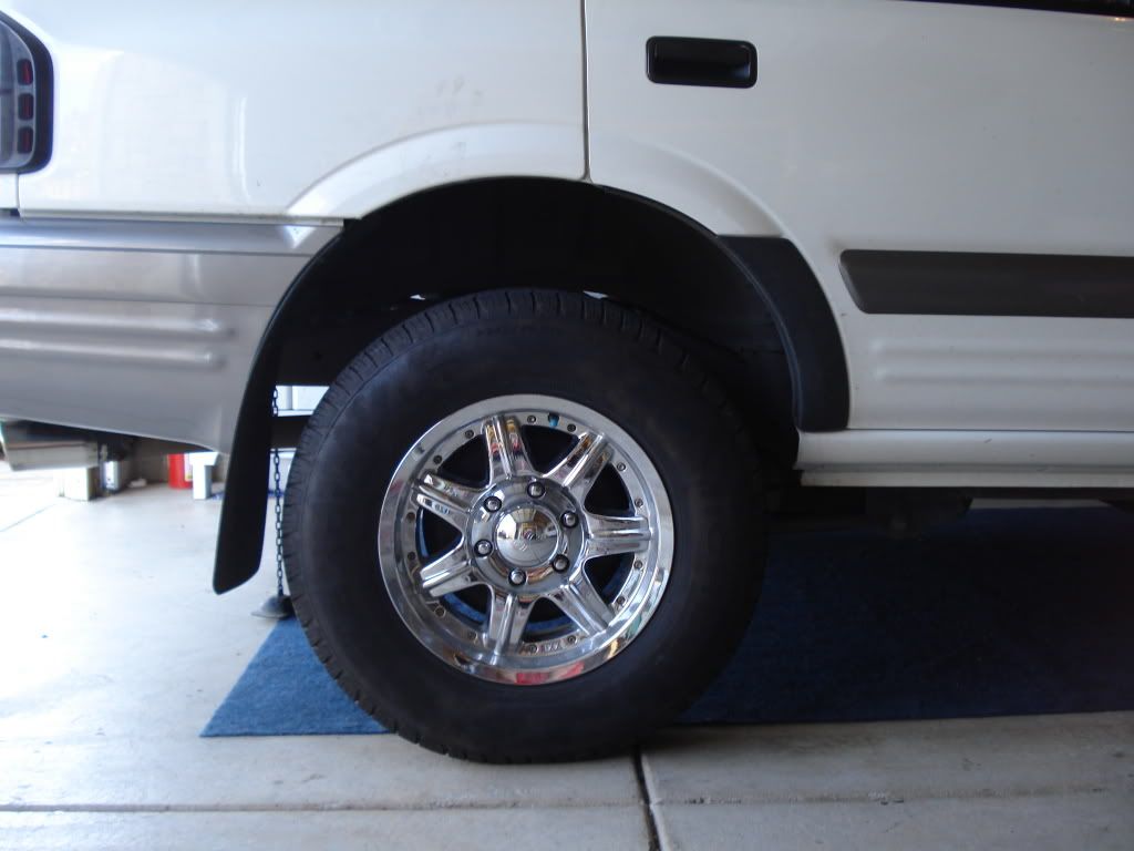

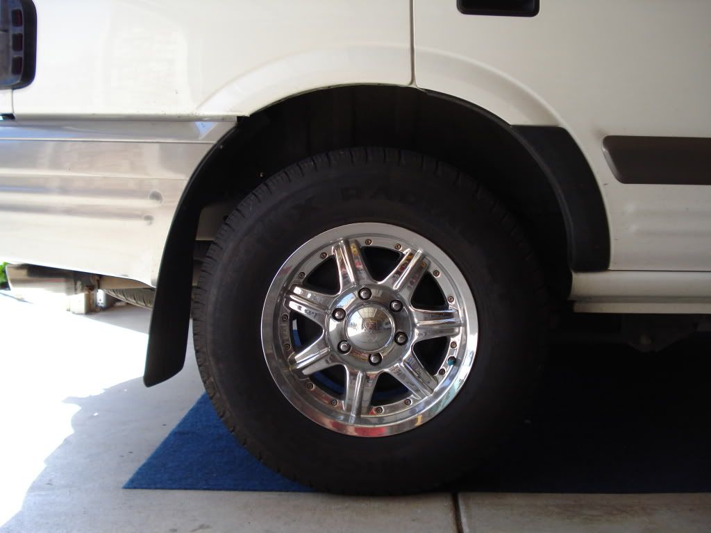

and keep reversing the steps and BAM! a nice two inch lift. my rears went from 33 1/4" to 35 1/4 " (top of fender wells) off the ground.
before:
after:
the lift looks higher in person. i just need to crank the t-bars in the front to match and hopefully sometime soon buy the zoo new rims and tires and im good! 8) the job really wasn't that hard and took me 3 hours to complete (and i was taking my time) hopefully this encourages some of you to DIY instead of bringing it to the shop and save some kee$$$hh, thats always good right?!
