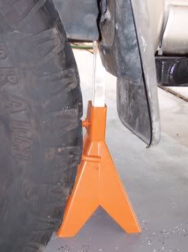

1. Jack up truck and remove the tire. Make sure to chuck your wheels and use a jack stand on the body of the truck.
We will be removing the upper ball first since it’s the easier of the 2. (I have done a ball joint flip on my trooper, so it might be different.)
