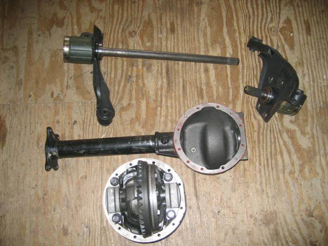

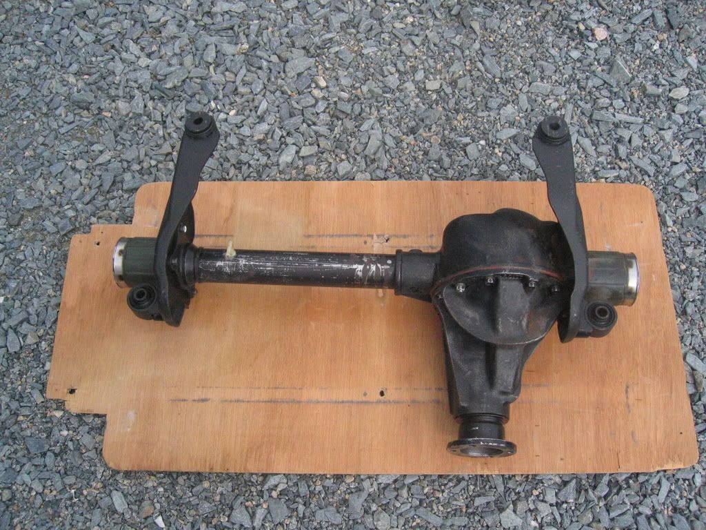

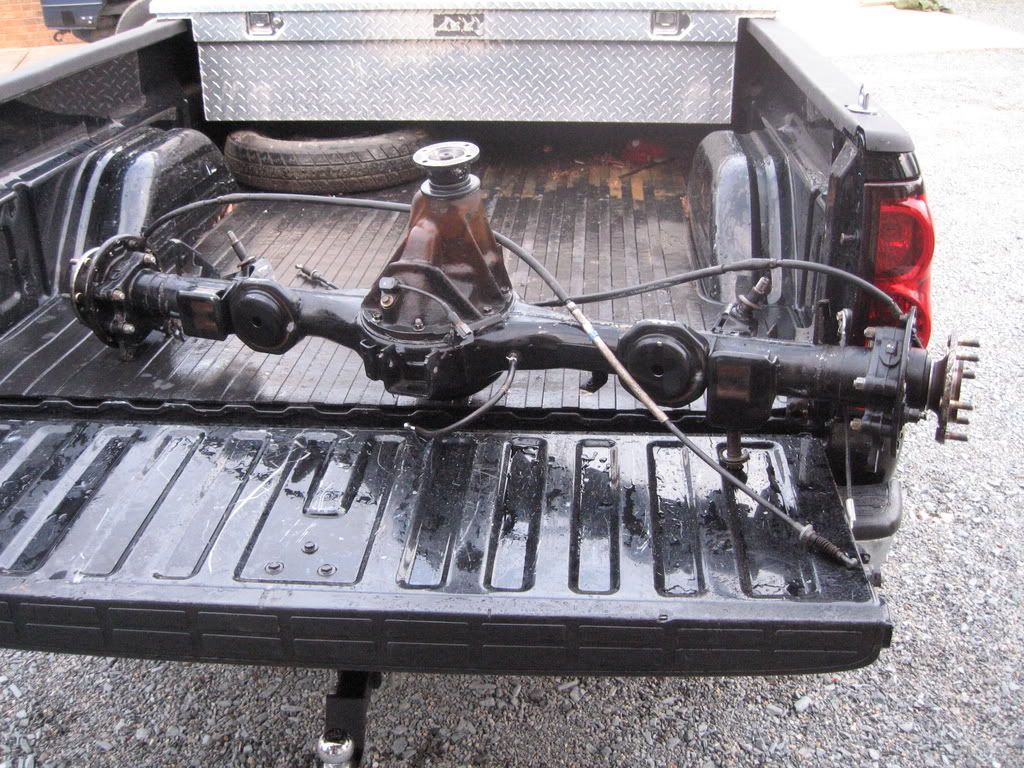

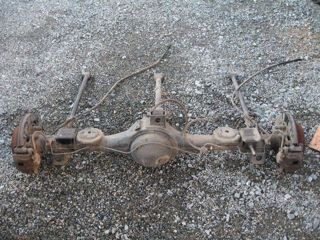

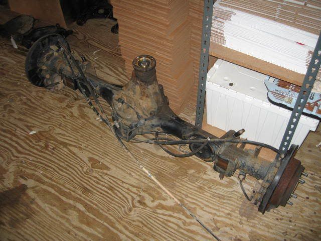

So off I went to Pull A Part and found a 96 Trooper There. Got the complete rear axle, front upper a arms (they are longer), lower ball Joints (they are longer) and cv axles. This will serve as the wide stance suspension swap.
96 TROOPER WIDE STANCE REAR AXLE - $68 From Pull A Part

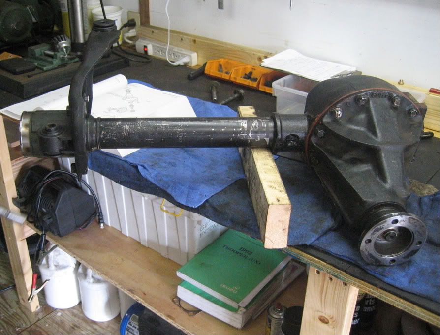

First job was to remove the rear brakes, knock off the dust shields, Remove the rear shafts then the 3rd member. Since I was lucky enough to find a set of 5:38 gears the 3rd member was sent to have the ring and pinion gears set up. (Something you do not want to do if you don't know how as you could destroy the gears).
REAR END WITH SHAFTS AND 3RD MEMBER REMOVED

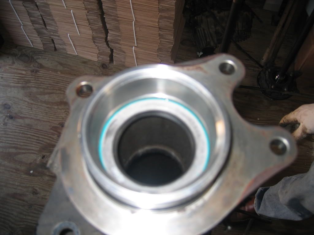

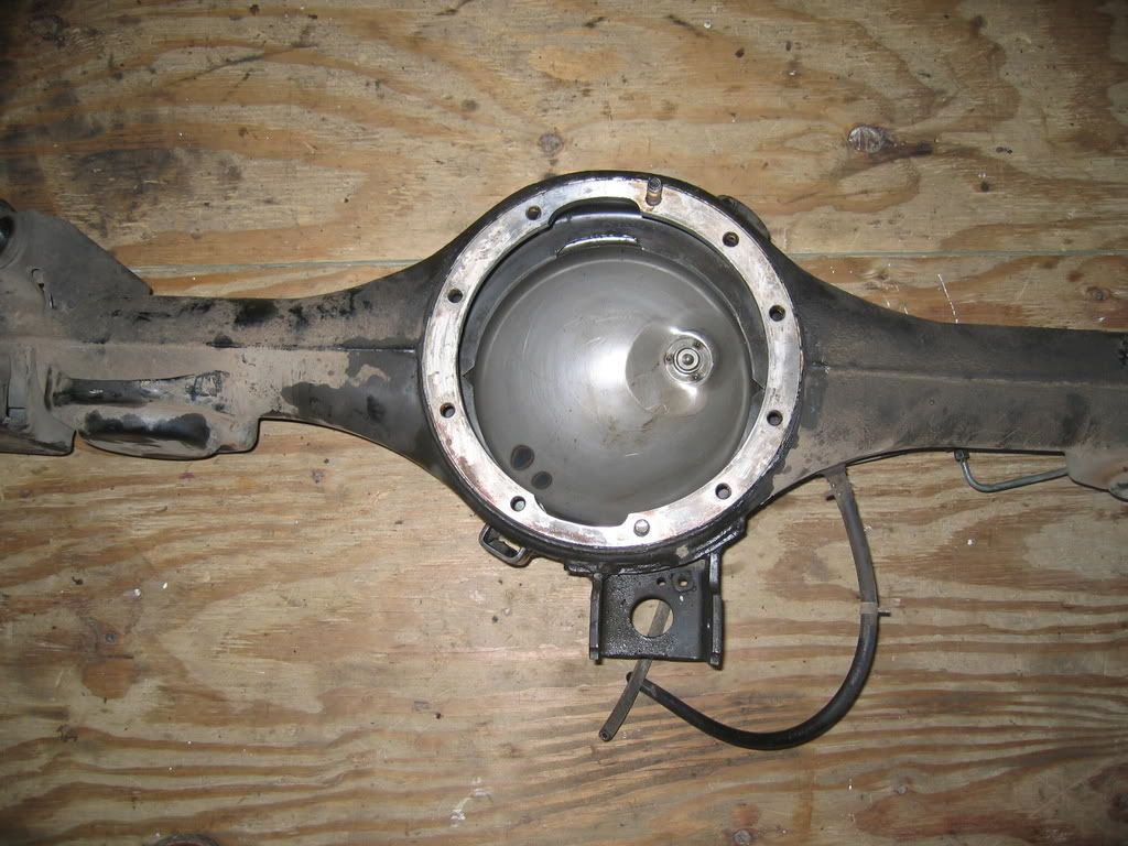

I them removed the seals from the axle housing and scrubbed the inside of the housing with kerosene to clean out the old gear oil residue.
REAR AXLE HOUSING CLEAN INSIDE
INSTALLED NEW SEALS IN THE HOUSING

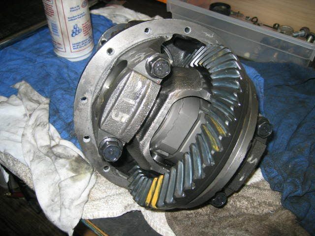

The 12 Bolt Aussie Rear Locker became available so I installed it in the 3rd member with the newly set up 5:38 gears.
First you remove the ring gear and take the spider gears out of the open carrier
Then you install the Aussie Locker in the open carrier, this does not affect your gear set up.
Reinstall the ring gear with lock-tite and torque. Reassemble the 3rd member. Not difficult, you just have to dive in.
FINISHED 3RD MEMBER WITH 5:38's AND AUSSIE LOCKER

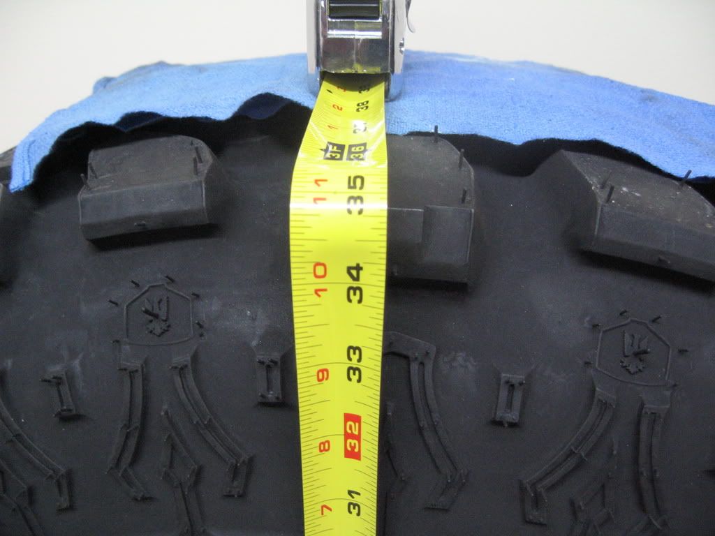

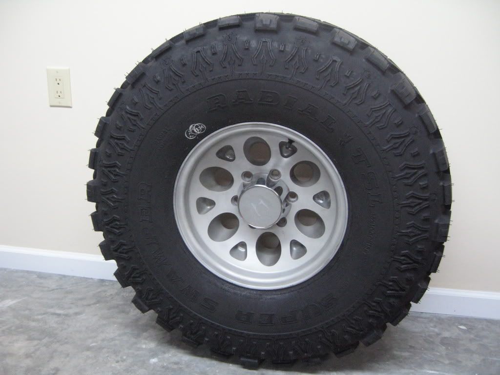

Since I will be using the Super Swamper Radial in 35x10.50-15 on a snowflake 15x7 rim, it's going to be a tight fit. I am doing a 1" body lift and a 3 inch suspension lift. Combined with a little hammering in the wheel wells, it should fit with the wide stance suspension. If not, I will use the saw.
MONSTER 35 SUPER SWAMPER RADIALS
YES THEY REALLY ARE TRUE 35's. LOOKS LIKE 35 1/4"

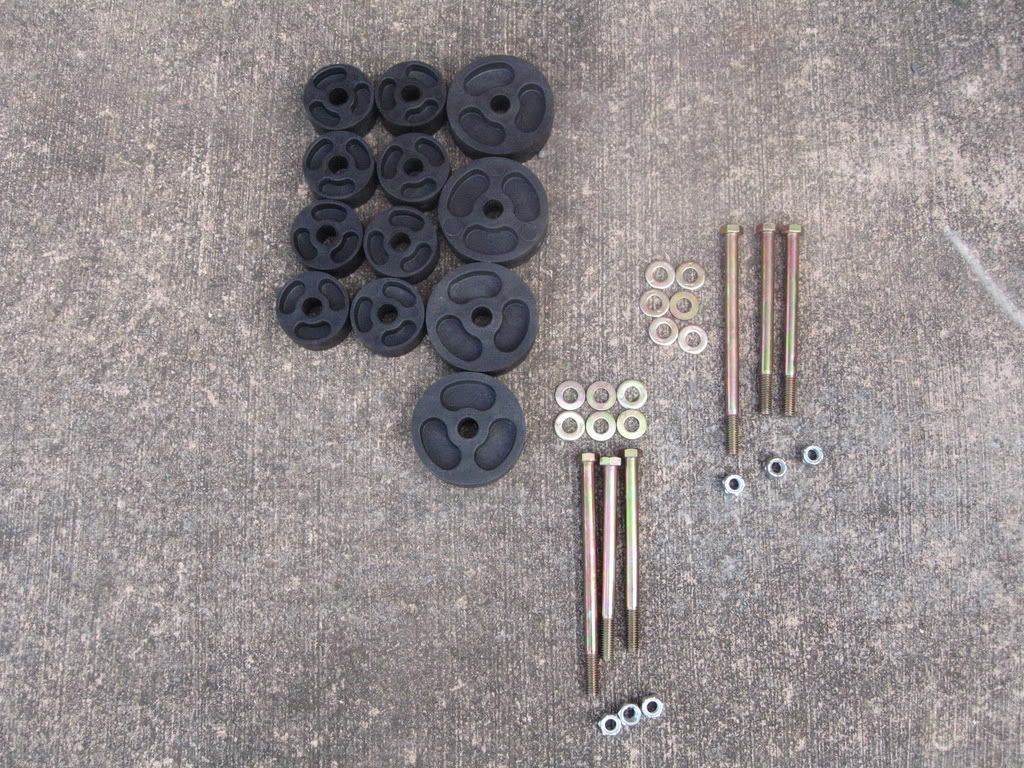

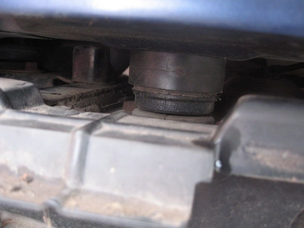

First thing to do on the body lift is to read the instructions and lay out the parts.
Next is to remove the front and rear bumper. 4 bolts hold the front bumper on and 4 bolts for the rear please a couple of small rear side bolts. Next is to loosen the front body bolt near the radiator support and you have to remove the interior carpet door plates to get to 2 bolts under the carpet. One in the front area another in the rear passenger floor area.

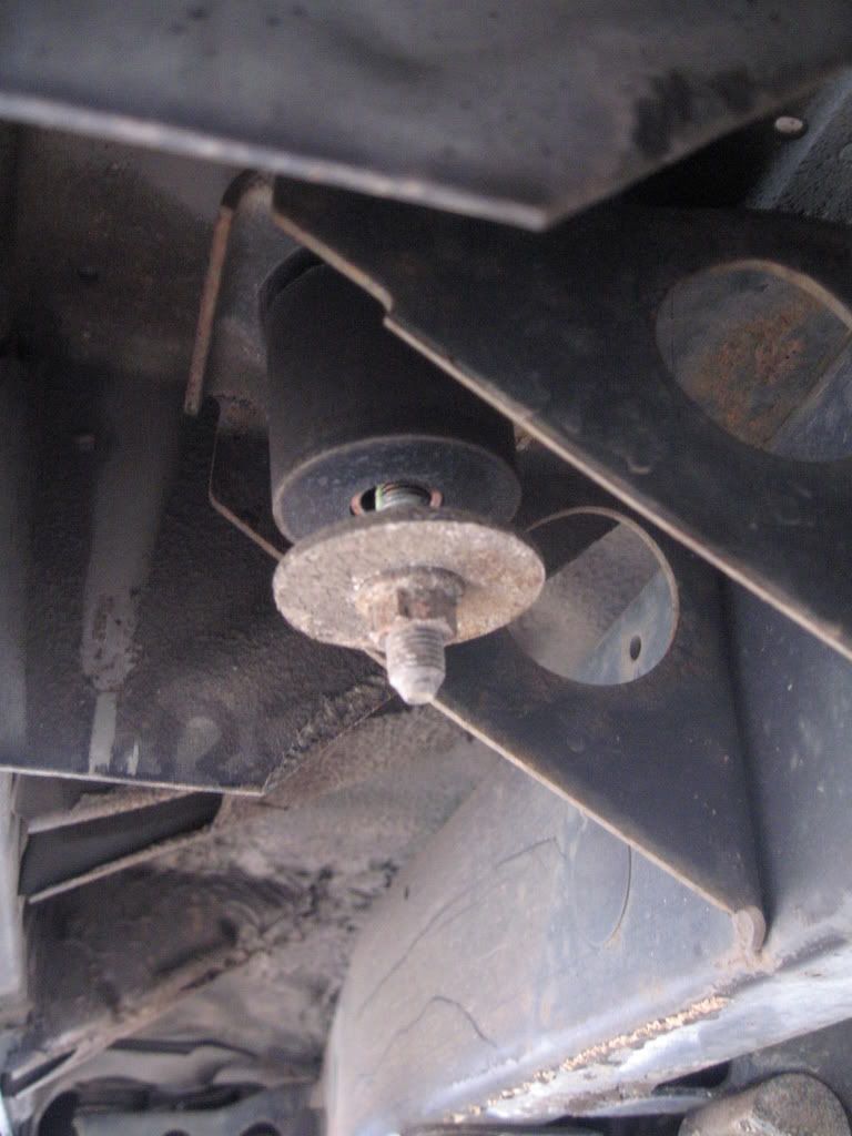

BODY BOLT UNDER THE FRAME
There is an additional bolt on the side and two bolts in the rear. You loosen all 6 bolts on each side without removing them. You remove the bolts from the drivers side, jack up the Trooper, insert the lift plucks above the factory bushing and insert the new bolts. You use the front three factory bolts on the rear three holes.
TROOPER BODY JACKED UP ON ONE SIDE - A 4x4 Wood Block is really handy
FRONT OF TROOPER WITH 1 INCH SPACER INSTALLED
REAR OF TROOPER WITH 1 INCH SPACER INSTALLED
92 TROOPER WITH 1 INCH BODY LIFT

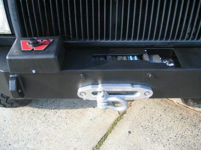

I did not reinstall the factory bumpers as I am going to build my own. Not sure how they will turn out but going to give it a good shot.

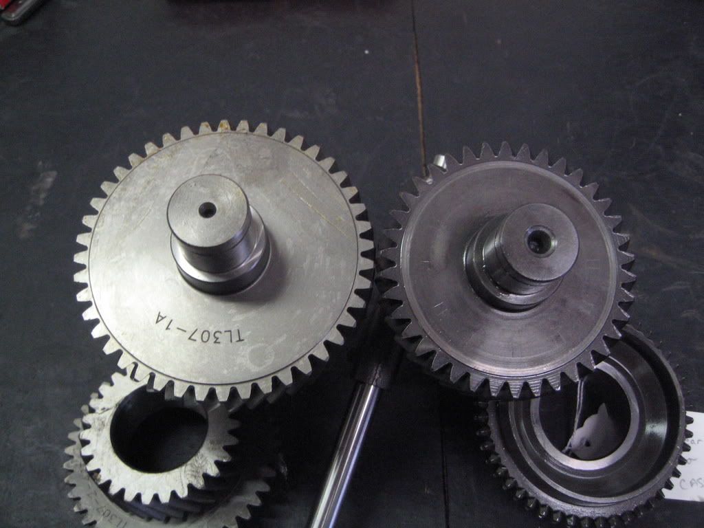

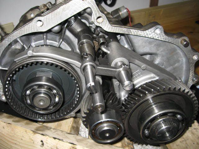

Luckily my friend gave me a transfer case out of a 95 Rodeo so I tore it down and installed the Tera Low Gear Set. With the help of Bigpoppax2 and a good friend I managed to get the Tera Low's in the transfer case.
TERA LOW GEAR ON LEFT VERSUS STOCK LOW GEAR ON RIGHT
TERA LOW'S IN TRANSFER CASE
TRANSFER CASE FILLED WITH PURPLE SYN OIL READY TO GO IN TROOP

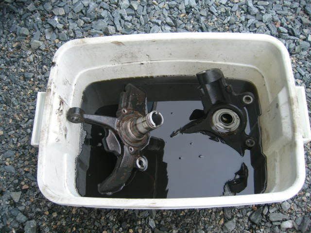

ImageI removed the old boots from the CV axles, soaked the axles in Kerosene, scrubbed them clean, greased and installed the Mecatech boots. Once again I would rather have good used Japanese CV's than new Chinese made copies.

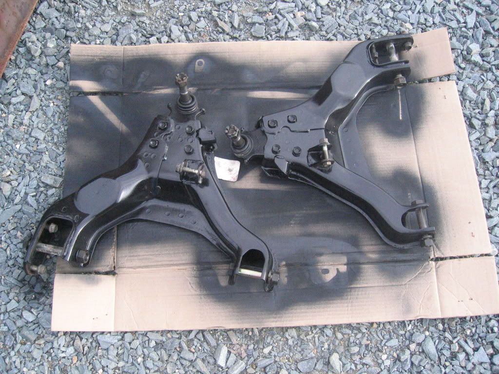

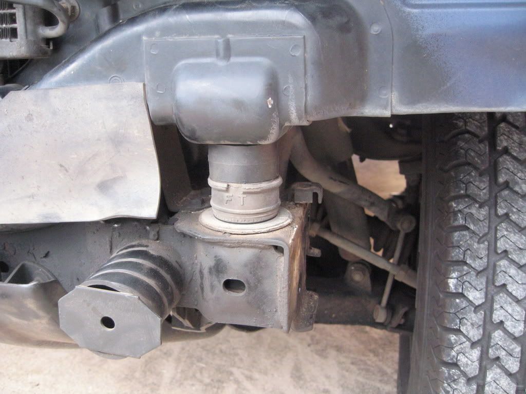

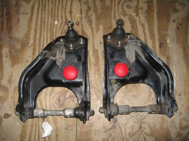

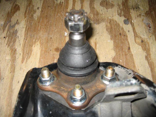

Cleaned up the upper A Arms, installed the ball joint spacer and flipped the ball joint to the underside. Since the ball joints were tight I greased them and installed a new Mecatech rubber boot.
WIDE STANCE A ARMS WITH BALL JOINT FLIP, SPACERS & BUMP STOPS
MECATECH BOOT ON BALL JOINT

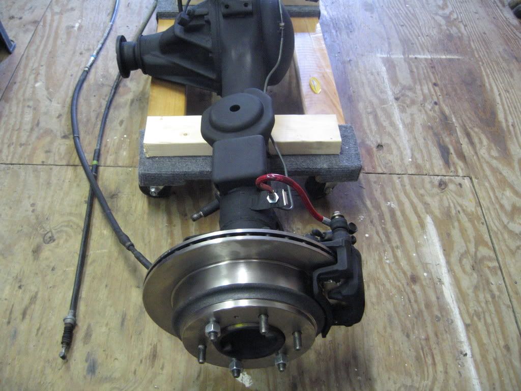

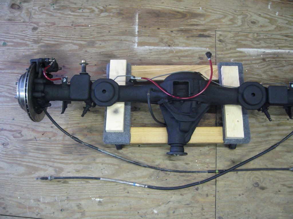

Finished painting the wide stance rear axle today and assembled the brakes with stainless brake lines. Unfortunately the Factory rear rotors were too far gone to turn and I had to get a set of Chinese made rotors. Next time I am at Pull A Part I will try and find OEM rotors to use.
WIDE STANCE REAR END READY TO GO IN THE TROOPER
Just need some new brake pads and the rear axle is complete

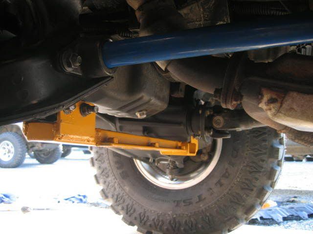

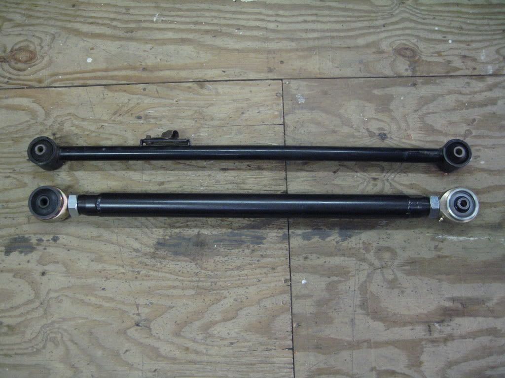

The Stock rear lower links are prone to bending with extreme wheeling. I will be installing a heavy duty set that is adjustable. As you raise the rear suspension of the Trooper the rear axle moves forward shortening your wheel base. These adjustable rear links allow you to move the rear axle back to it's original position. The 3rd rear link that connects to the top of the rear axle is also adjustable that allows you to adjust your pinion angle as needed with the lift.
STOCK REAR LOWER LINK COMPARED TO MONSTER ADJUSTABLE LINK

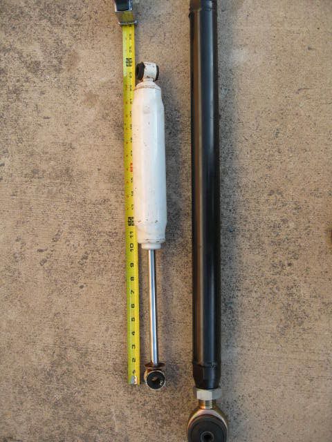

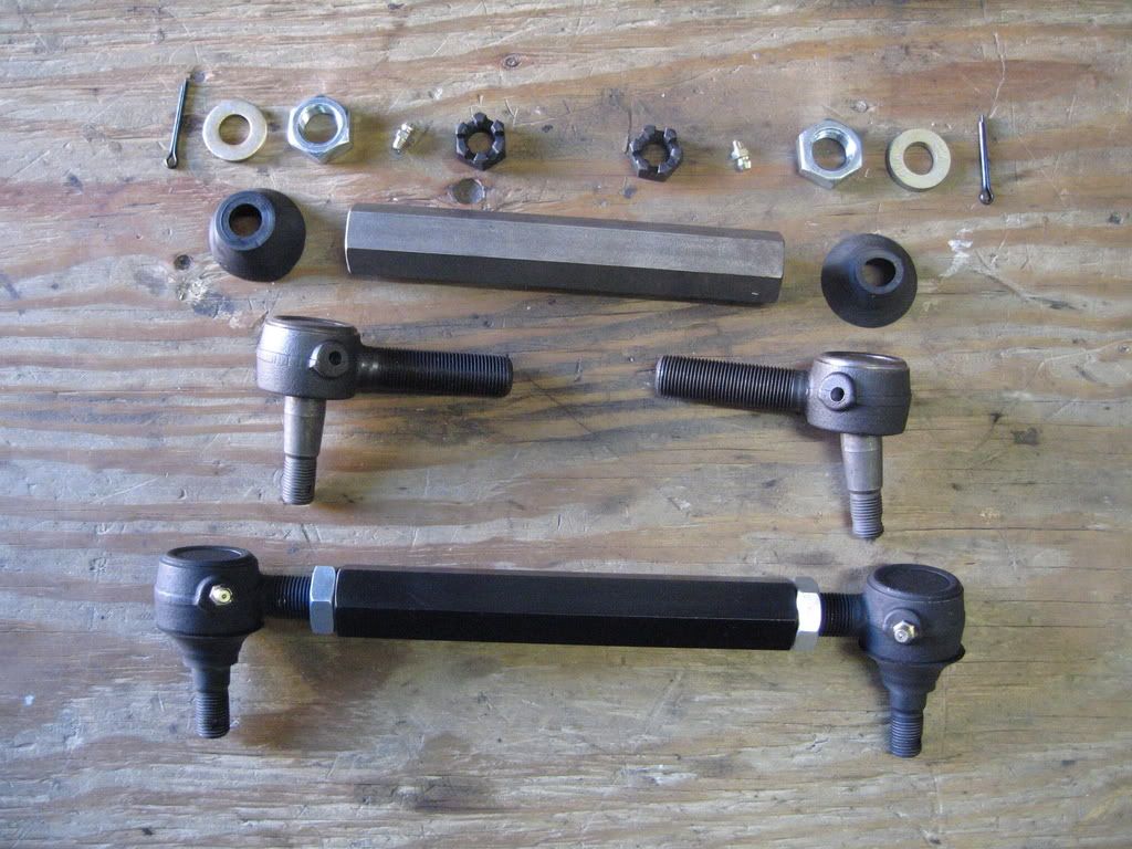

The factory Isuzu tie-rods will break with monster tires and rock crawling. I will be installing a set of heavy duty tie rods. These are truly massive and you will not break them.
The heavy duty tie rod's come unassembled and un-painted.
HEAVY DUTY TIE-ROD BEFORE AND AFTER ASSEMBLY & PAINTING

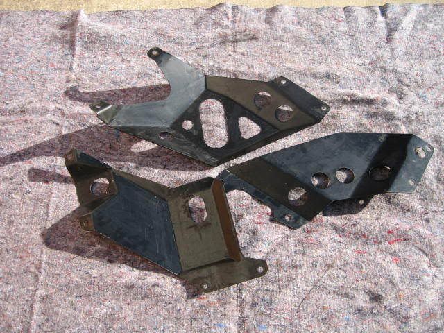

While I am waiting for the front 5:38 ring gear to be machined, it's time to install the transfer case with the Tera Low Gear.

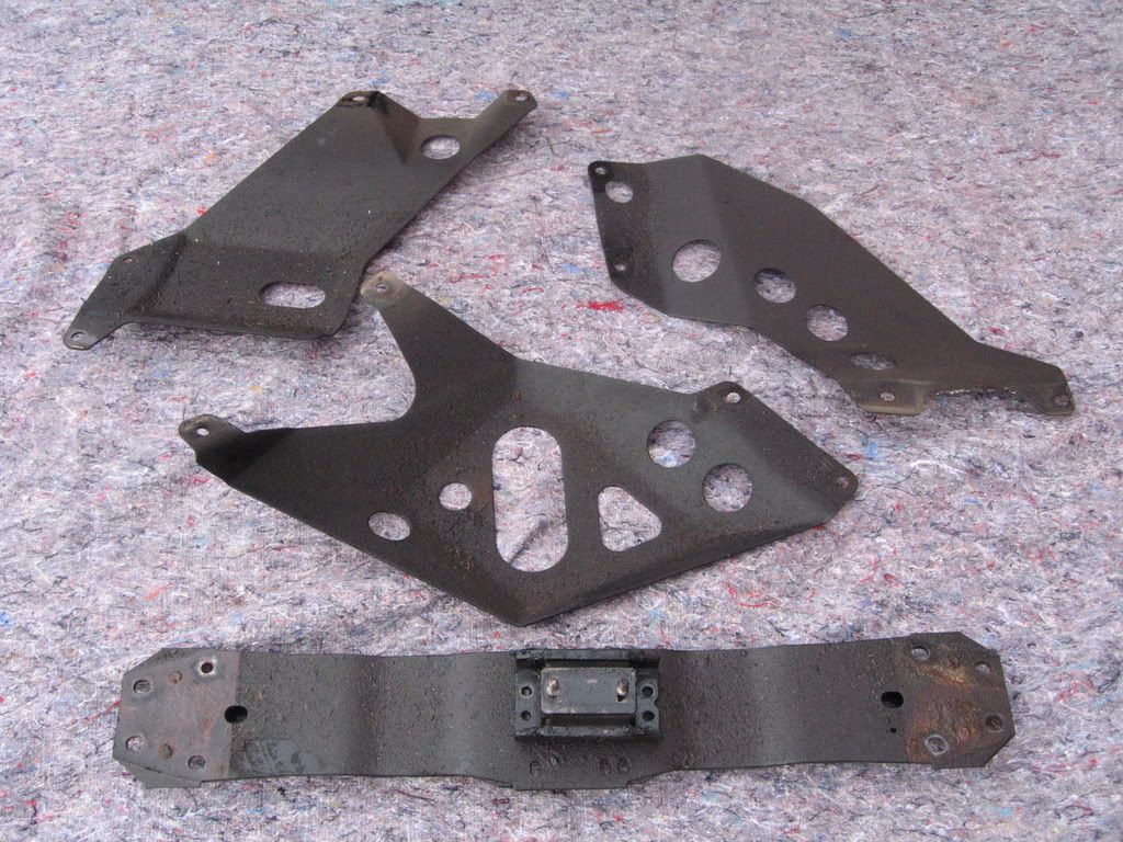

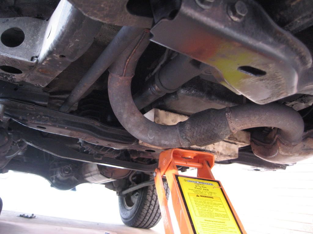

First thing to do is remove the three skid plates and then the front and rear driveshaft. Next place a jack under the transmission to support it when you remove the tansmission support crossmember.
JACK SUPPORTING TRANSMISSION WHILE REMOVING CROSSMEMBER
THREE SKIDPLATES AND TRANSMISSION CROSSMEMBER
Before cleaning and degreasing. I scraped them first with a putty knife to remove the heavy grease then I spayed and scrubbed them with Simple Green, a fantastic degreaser. They cleaned up very well.

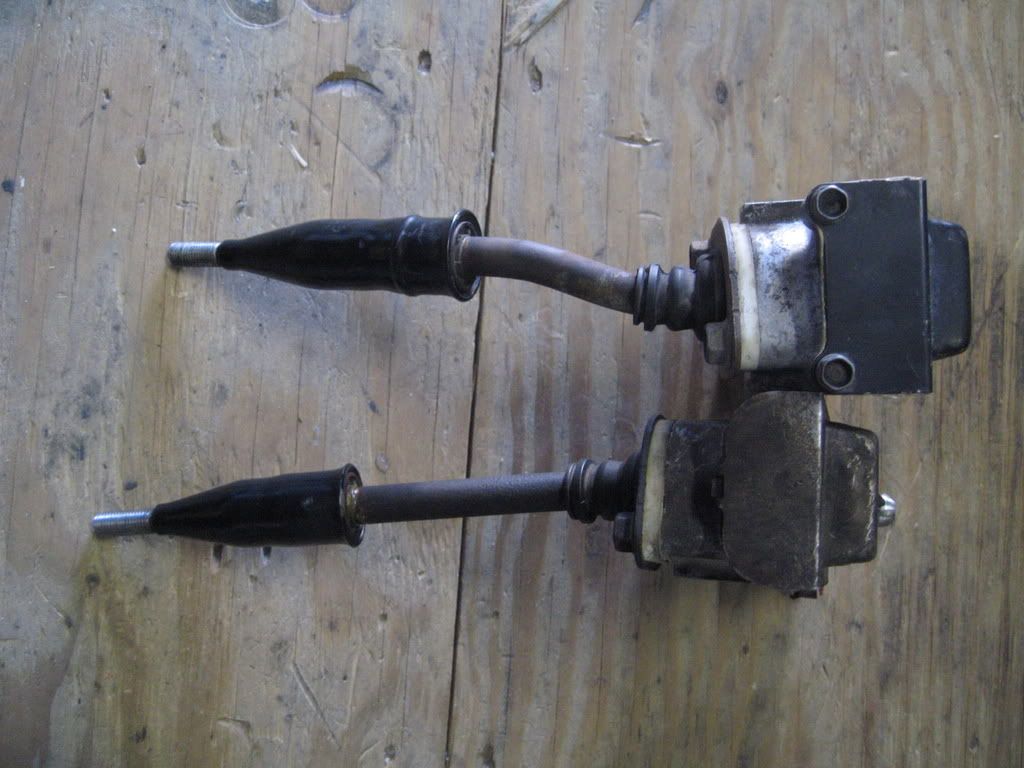

I got the transfer case all back in and it looks like the actual shifter is slightly different from the Rodeo to the Trooper. There is no room to shift the transfer case as the shifter hits the wall of the body. Looks like I will have to pull the transfer case out again and switch the actual shifter . Like I said the learning curve is vertical. It's all part of a build.
I pulled the transfer case out of the Trooper again and when I compared the rodeo shifter to the trooper shifter it was different. The rodeo shifter is straighter. Removed the 4 bolts holding the shifter arm and replaced the rodeo shifter with the trooper shifter.
TROOPER SHIFTER ABOVE, RODEO SHIFTER BELOW

CLEANED AND DEGREASED SKID PLATES
TRANSFER CASE BACK IN TROOPER WITH TERA LOW INSTALLED.
As you can see the crossmember and skid plates are nice and clean. I also just noticed that the cat looks like it was installed backwards by the previous owner. Not sure it makes a difference but I will probably switch it.

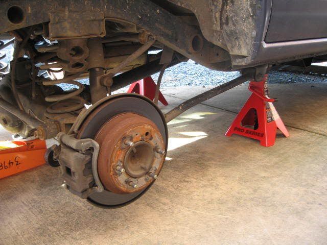

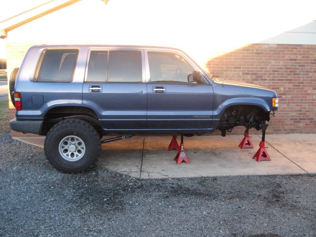

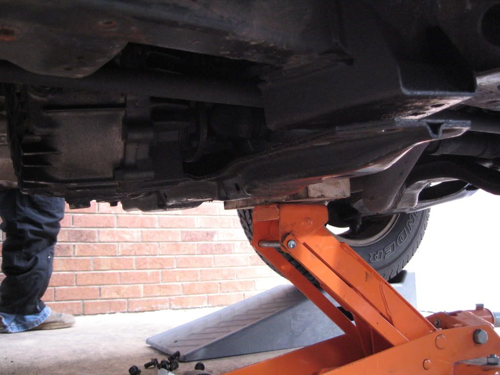

It looks like the front ring gear may be ready the end of this week so I decided to remove the rear axle today.

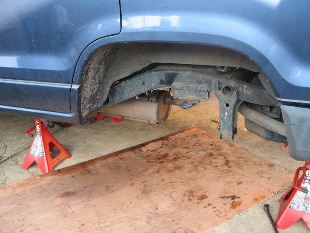

JACKED UP THE TROOPER, REMOVED TIRES & PLACED REAR ON 4 JACK STANDS - 2 in front of the link mount & 2 near the rear bumper mount.
You can see the bent factory lower link below

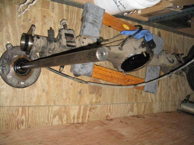

First removed was the drive shaft, then the rear shocks, sway bar links, frame bolts for the link rod's, removed parking brake cables, unplugged ABS brake sensor, removed upper brake line and 3rd member breather hose. Once everything was unplugged and unbolted the rear axle was removed.
NARROW AXLE OUT OF THE 92 TROOPER
TROOPER MINUS AXLE

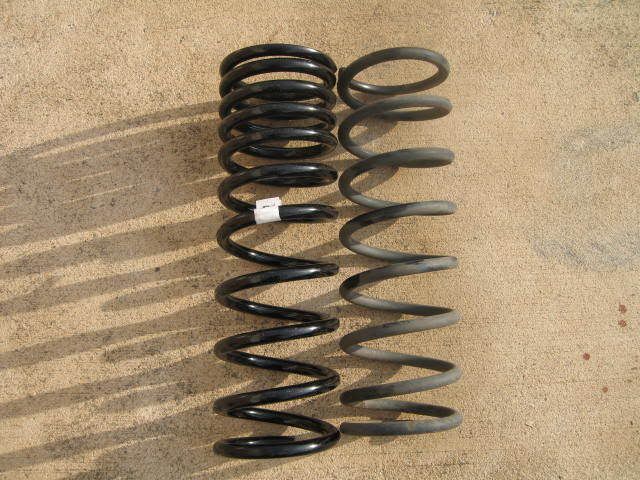

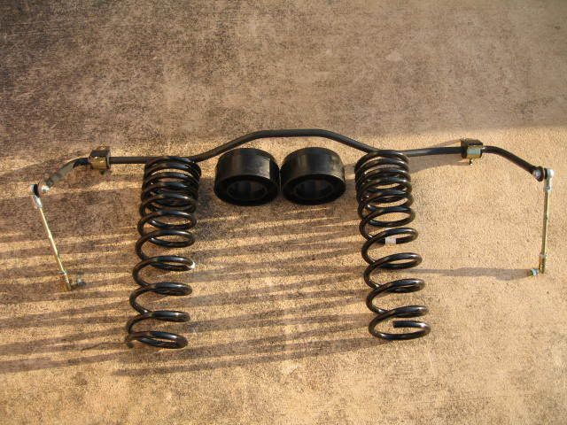

I will be installing the OME 919 springs with 2 inch spacers, quick disconnect sway bar links and the heavy duty rear lower links.
OME 919 SPRING ON LEFT, FACTORY SPRING ON RIGHT
SWAY BAR WITH QUICK DISCONNECT LINKS, POLY BUSHINGS, 2 INCH SPACERS & OME 919 SPRINGS

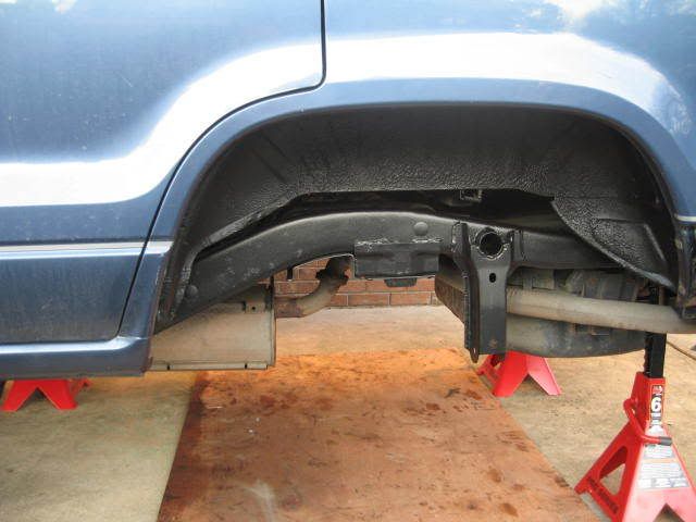

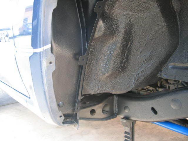

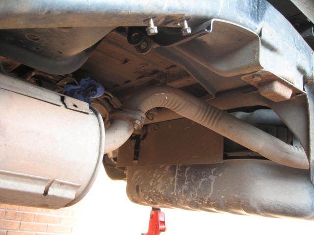

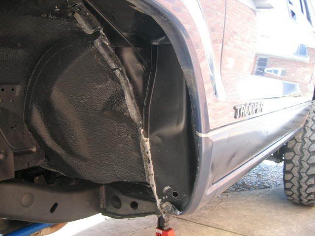

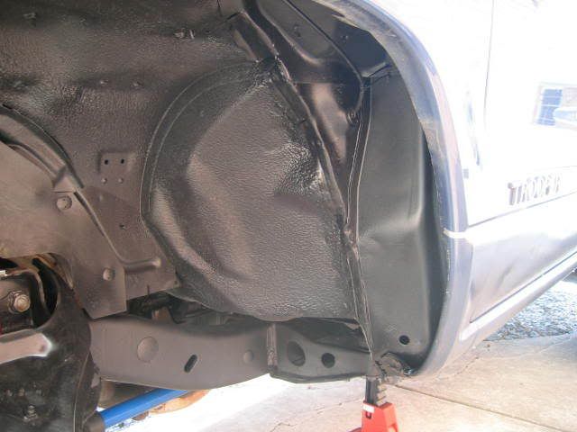

With the rear axle out I decided to spray the wheel well with smooth bedliner spay. Should be ready to install the wide stance axle tomorrow
CLEANED UP WHEEL WELL WITH BEDLINER SPRAY

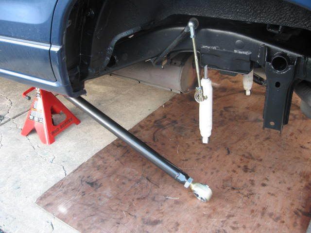

Will be installling a pair of gently used Pro Comp shocks. These are longer for axle articulation and measure 23 inches center to center bolt holes.
PRO COMP SHOCK AND LOWER LINK READY TO INSTALL
Decided to install the rear axle today. First to go in was the rear sway bar with the new poly bushings and quick disconnect links. Next was the 23" Pro Comp shocks. Measured each lower link and adjusted the to 1/2" longer than stock.
SWAY BAR WITH QD LINKS INSTALLED, 23" SHOCKS & LOWER LINK

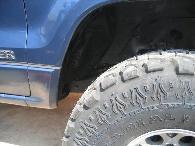

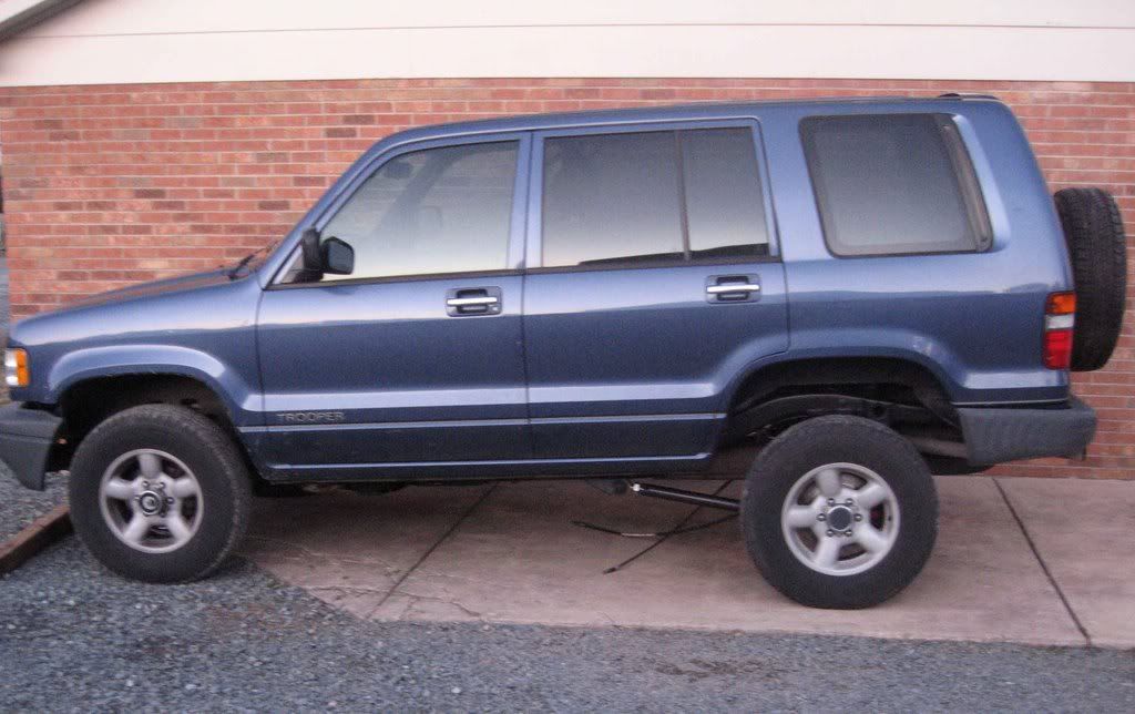

Put the rear wheel on just to get an idea of the lift and WOW !! thats tall, and the 35's are not on yet.
LIFTED WIDE STANCE REAR AXLE, STOCK HEIGHT FRONT - MAD MAX MACHINE

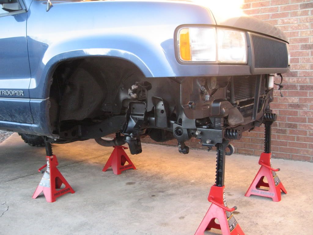

Finally after three months of waiting I got the front 5:38 ring gear machined for the ring and it is in the 3rd member. The project is back on track. Pulled all the front suspension and axle off the trooper. It will be easier to show in detail the re-install with clean parts. Will be installing the 10 bolt 5:38 gears & aussie locker with the diff drop brackets, wide stance upper arms, wide stance longer CV axles, Wide stance lower ball joints, Calmini tortion bars, poly sway bar bushings, stainless brake lines, heavy duty tie rods ,QD sway bar links and all the other front end gear.
TROOPER WITH FRONT SUSPENSION REMOVED

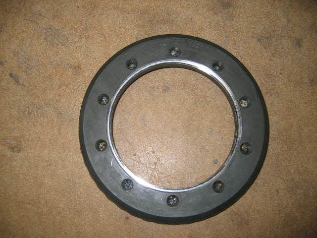

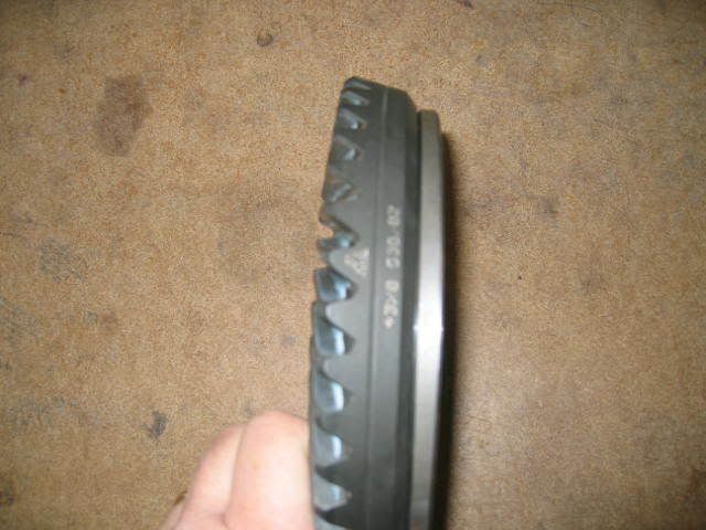

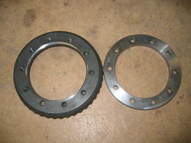

Here is the pesky 5:38 ring gear that had to be machined. I was told that whoever had sent the gear manufacturer the ring and pinion gear for the 10 bolt front Isuzu, sent them the 10 bolt older rear gears instead, hence having to have the ring gear machined to accept the spacer. Finaly after 3 months of tortured waiting it is done.
5:38 RING GEAR AFTER BEING MACHINED FOR SPACER
MACHINED 5:38 RING GEAR WITH SPACER
SIDE VIEW OF SPACER ON MACHINED 5:38 RING GEAR

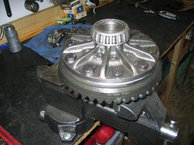

Even finding the longer machine scews to hold the carrier and spacer on the ring gear was a real pain. They are 10mm 1.00 extra fine thread and need grade 8.

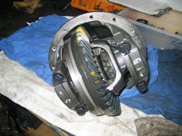

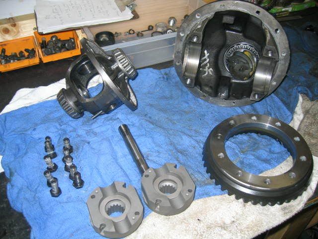

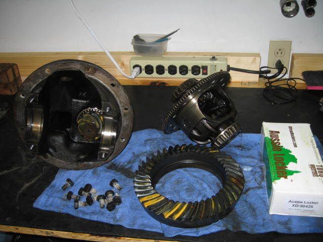

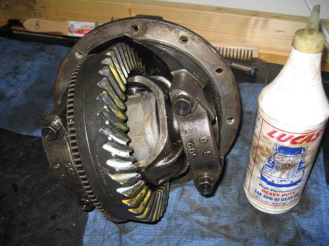

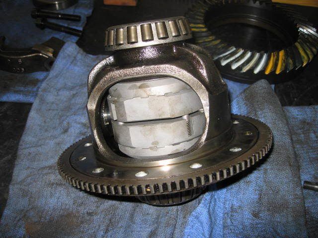

Received the 10 bolt 3rd member back from having the 5:38 gears set up.
Removed the carrier and installed the Aussie Locker. Applied Loc-Tite and set the torque on the bolts and FINALLY the front was complete with 5:38 gears. Did I mention it was tough waiting 3 months for the ring gear to be machined.
10BOLT 3RD MEMBER WITH INSTALLED 5:38 GEARS AND OPEN CARRIER
CARRIER OUT OF FRONT 3RD MEMBER, AUSSIE LOCKER WAITING TO GO IN
THE HARD TO FIND LONGER BOLTS FOR THE CARRIER, SPACER AND RING GEAR. RED LOC_TITE AND TORQUED TO 80 POUNDS
FINISHED 3RD MEMBER WITH 5:38 GEARS AND AUSSIE LOCKER INSTALLED

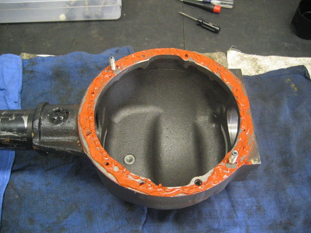

FRONT AXLE READY TO BE PUT BACK TOGETHER WITH DARLINGTON DIFF DROP BRACKETS
PUTTING THE AXLE BACK TOGETHER. PLENTY OF HIGH TEMP RTV SEALER

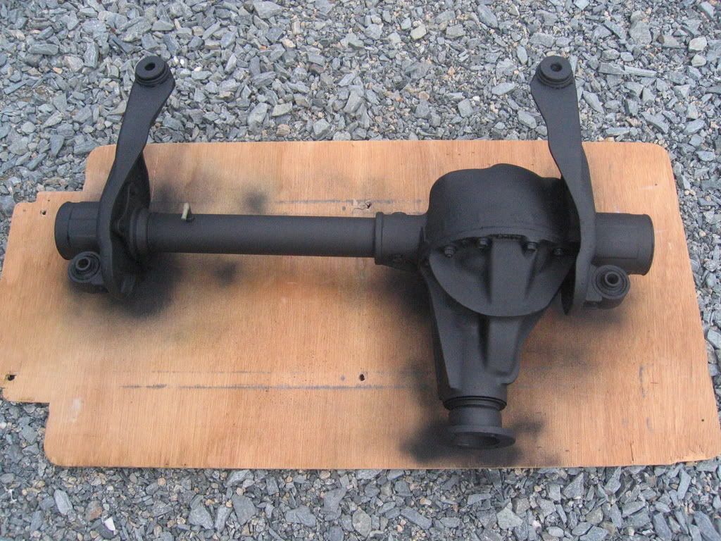

FRONT AXLE ASSEMBLED AND DEGREASED READY FOR PAINTING
AFTER A COAT OF PAINT AXLE LOOKS FANTASTIC

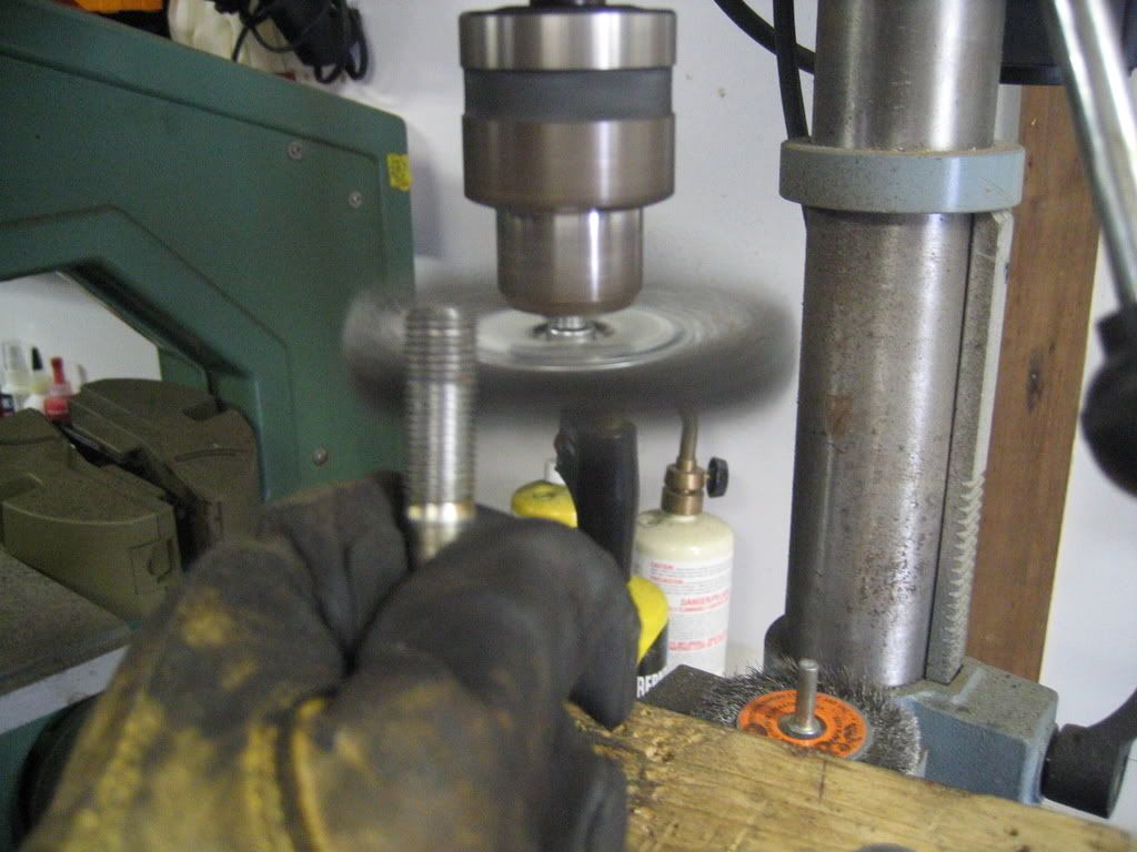

I have found that a wire circular wheel on a drill press is wonderful for cleaning rust and crub off all your bolt before installing back in the vehicle. Saves you from binding up a bolt and breaking it.
CLEANING CRUD OFF ALL BOLTS WITH A WIRE WHEEL ON A DRILL PRESS

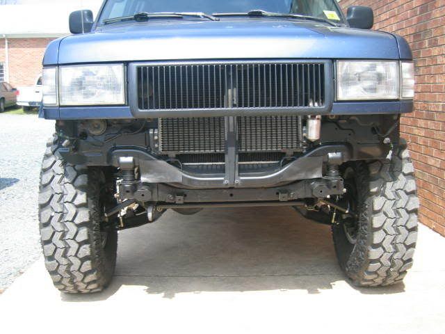

FRONT AXLE GOING BACK INTO TROOPER

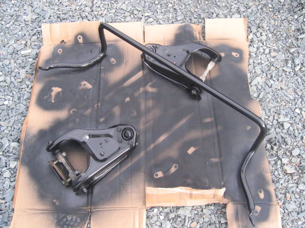

Before installing the A-Arms I cleaned them up and painted them
PAINTING THE PARTS BEFORE INSTALLATION.
YOU DON'T NEED A FANCY CLEANING TANK TO GET THE JOB DONE. KEROSENE WORKS WELL AND CAN BE REUSED.

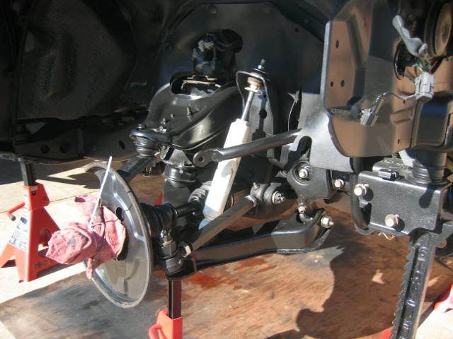

Installed the lower A-Arm with wide stance lower ball joint, installed the longer wide stance upper A-Arm and the longer wide stance CV axle.
WIDE STANCE UPPER A-ARM, LONGER LOWER BOLT JOINT AND WIDE STANCE CV AXLES - I LATER REALIZED I HAD THE LOWER BALL JOINT ON UPSIDE DOWN
Went to install the wheel spindle and the lower ball joint did not want to go in, realized the lower ball joint was installed upside down. That's the problem with not being a mechanic, stupid mistakes can waste a couple of hours. All part of the fun though.
LOWER BALL JOINT INSTALLED THE CORRECT SIDE DOWN
WITH THE LOWER BALL JOINT FACING THE CORRECT WAY THE WHEEL SPINDLE WENT ON EASILY
[Image
INSTALLED SWAY BAR WITH POLY BUSHINGS, SHOCK, BRAKE DUST SHIELD AND HEAVVY DUTY TIE ROD

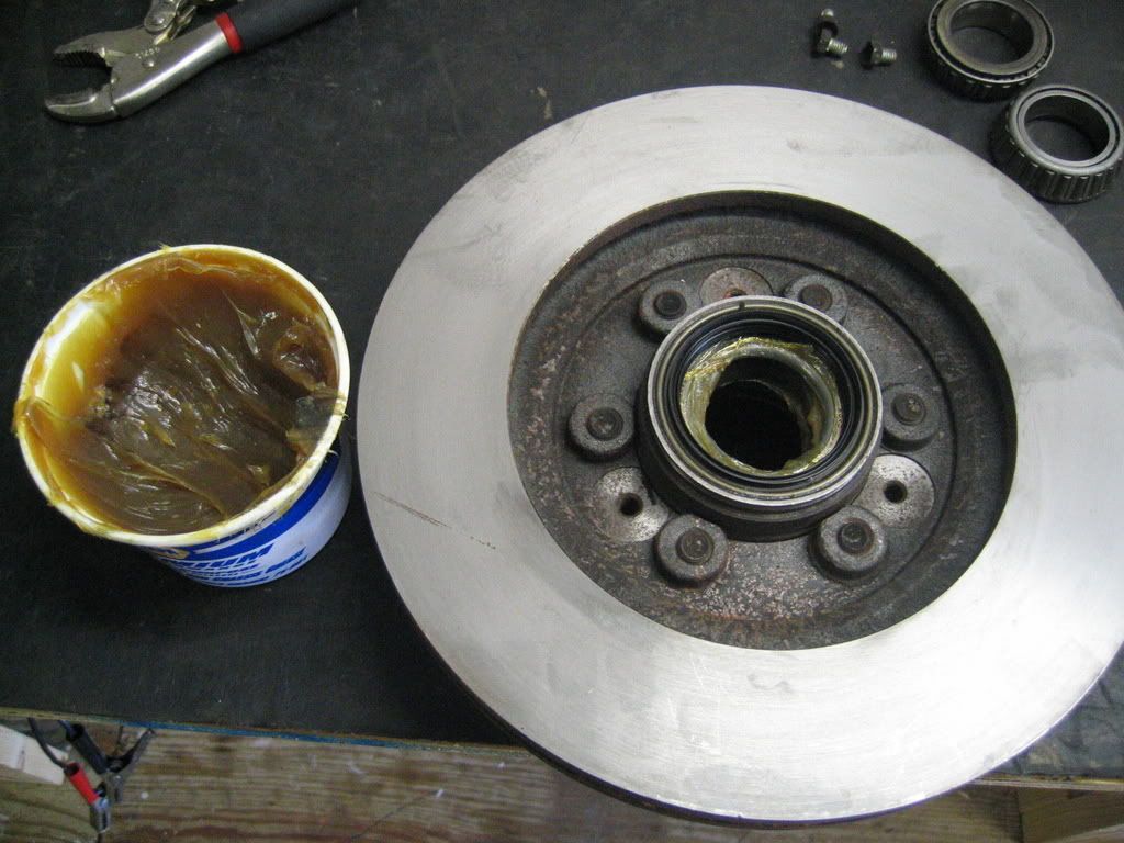

Installed the cleaned inner and outer wheel bearings in the turned rotor and hub. Installed a new oil seal in the inner hub.
REPACKED CLEANED BEARING AND NEW OIL SEAL IN BRAKE ROTOR AND HUB
ROTOR AND HUB BACK ON WHEEL SPINDLE

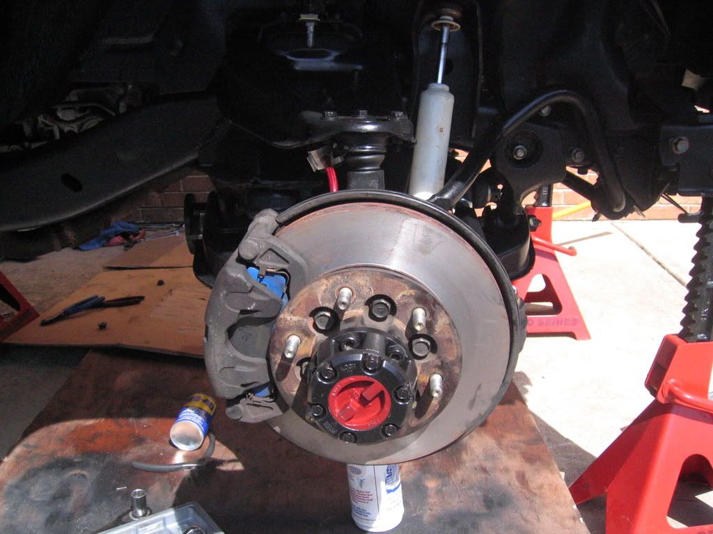

Installed the brake caliper with pads, the stainless brake line, a set of junk yard cleaned and painted Asin manual hubs and the front end is back together.
COMPLETED FRONT END WITH ASIN MANUAL HUBS

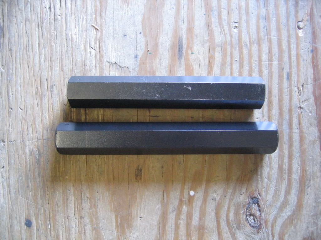

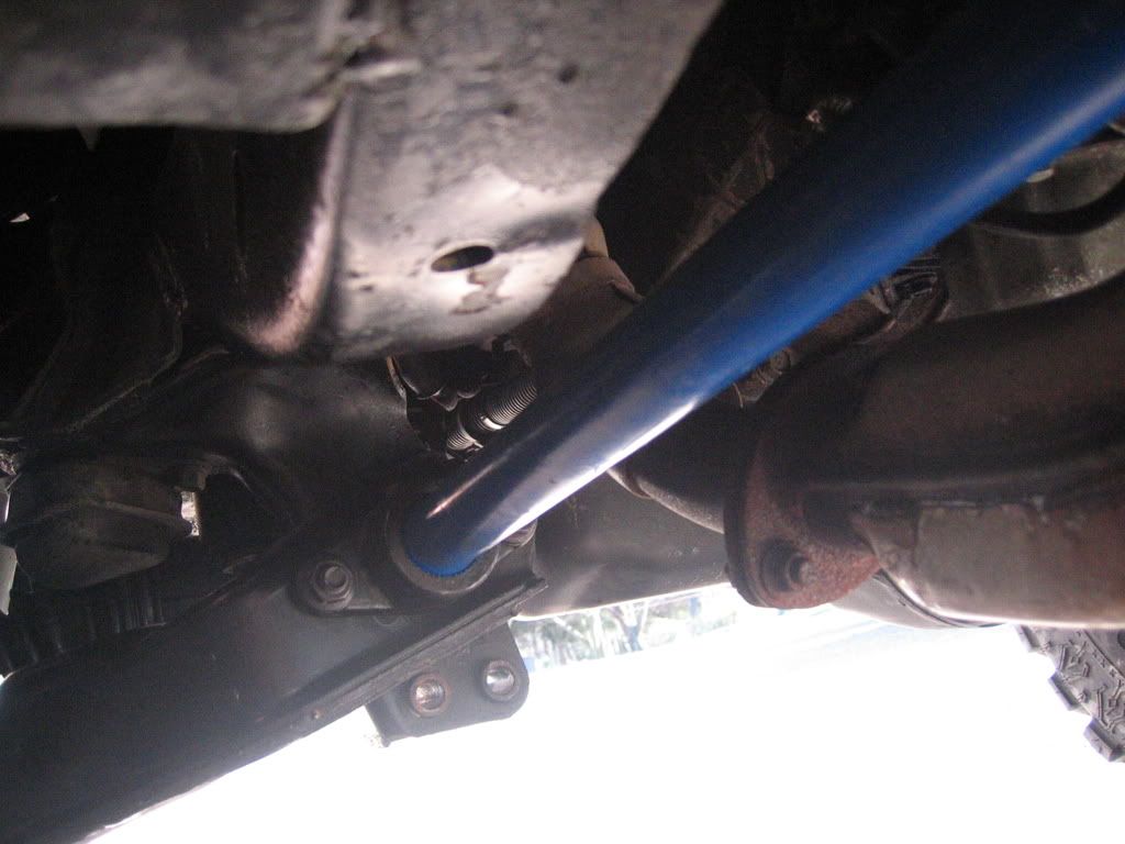

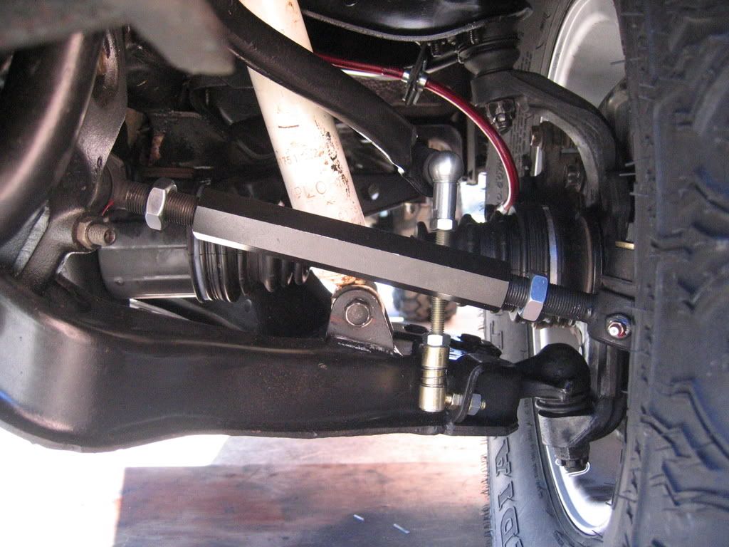

Sprayed the brake rotors with brake cleaner to degrease them. When I installed the HD tie rods I noticed them seemed too short ans lots of thread stuck out. Forgot to keep in mind the wide stance swap when getting the HD tie rods. Matt was kind enough to exchange the center bars for longer ones. Had 7 1/2" center bars, needed the longest 8 1/2" ones.
FRONT END TOGETHER, INSTALLED QD SWAY BAR DISCONNECT. THE TIED ROD CENTER BARS SEEM A BIT SHORT - NOTE THE FLAT CV AS THE TORTION BARS HAVE NOT BEEN CRANKED YET.
EXCHANGED FOR LONGER TIE ROD CENTER BARS (BOTTOM ) 8 1/2" LONG

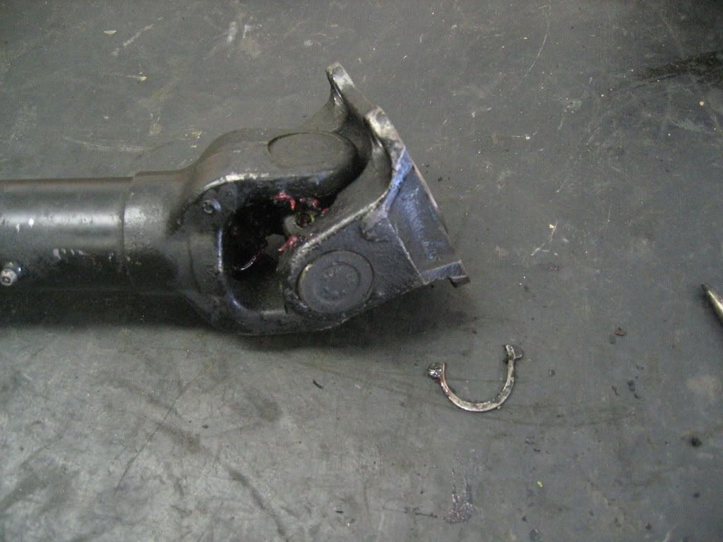

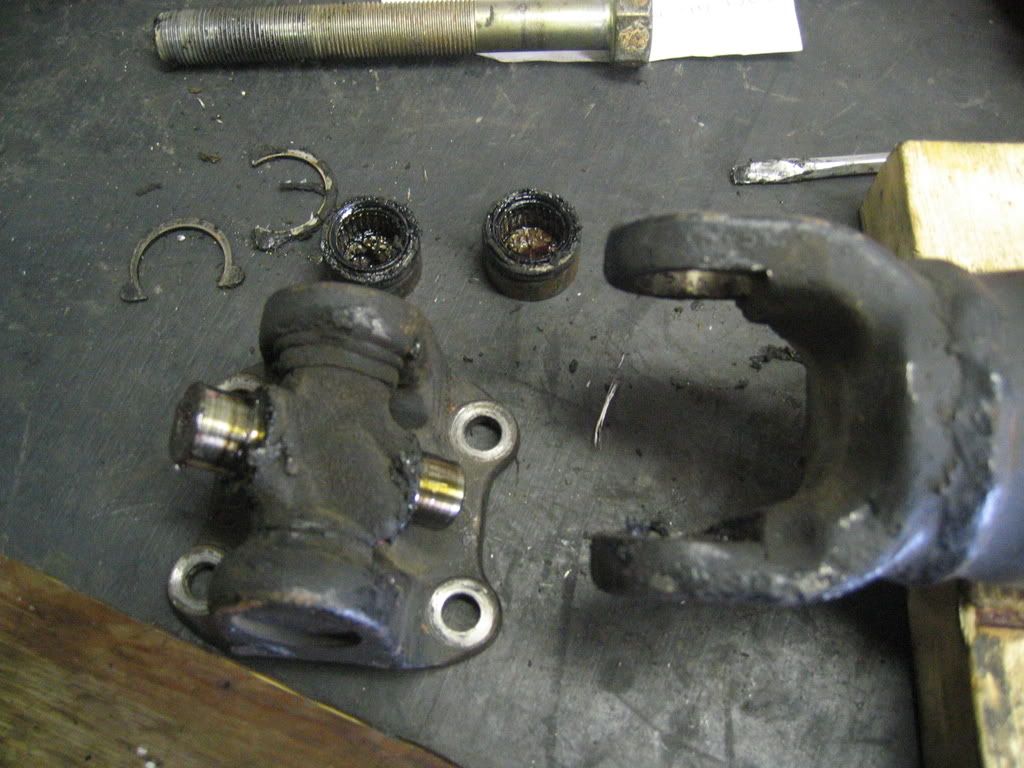

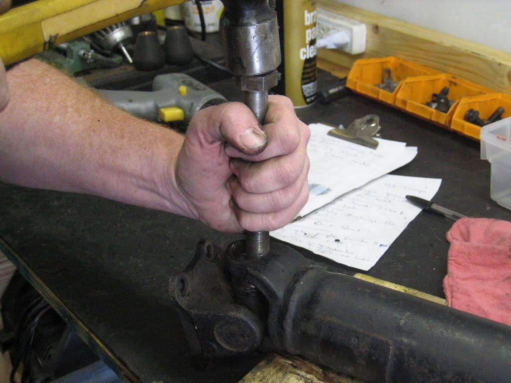

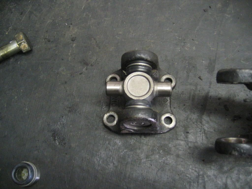

I came to the conclusion that after 160K miles the U-Joints were probably worn and 35"s locked were not going to help them so I decided to change them. Had to look through 8 boxes to find the Japanese made ones. As the older parts are sold all the new parts are made in China and probably won't hold up to serious wheeling.
START BY POPPING OFF THE CLIPS ON THE INSIDE OF THE U-JOINT
REMOVE THE GREASE NIPPLE AND HAMMER THE CAP DOWN
POP THE CAPS OFF AND THE U-JOINT COMES APART
ONCE THE U-JOINT IS OUT, INSTALL THE NEW JOINT AND TAP THE CAPS ON
DRIVE SHAFT WITH NEW U-JOINT

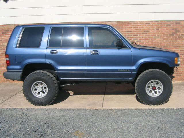

92 TROOPER WITH WIDE STANCE SUSPENSION SWAP, 35'S, LOCKED FRONT AND REAR WITH 5:38 GEARS. A TRUE IFS MONSTER.

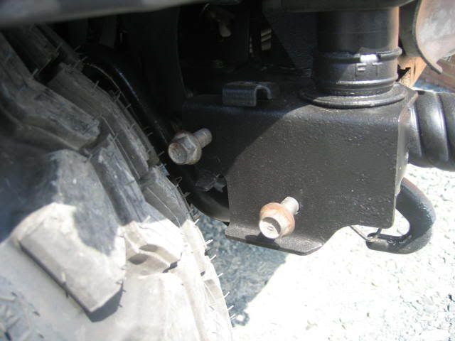

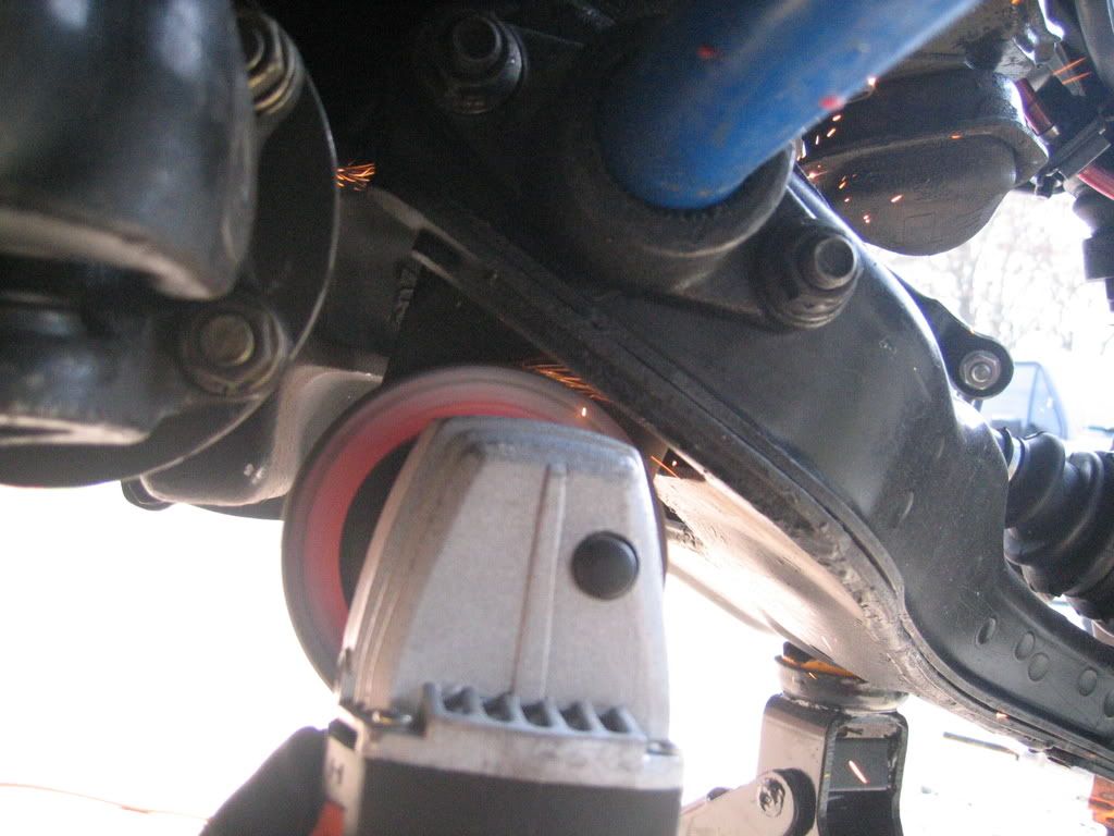

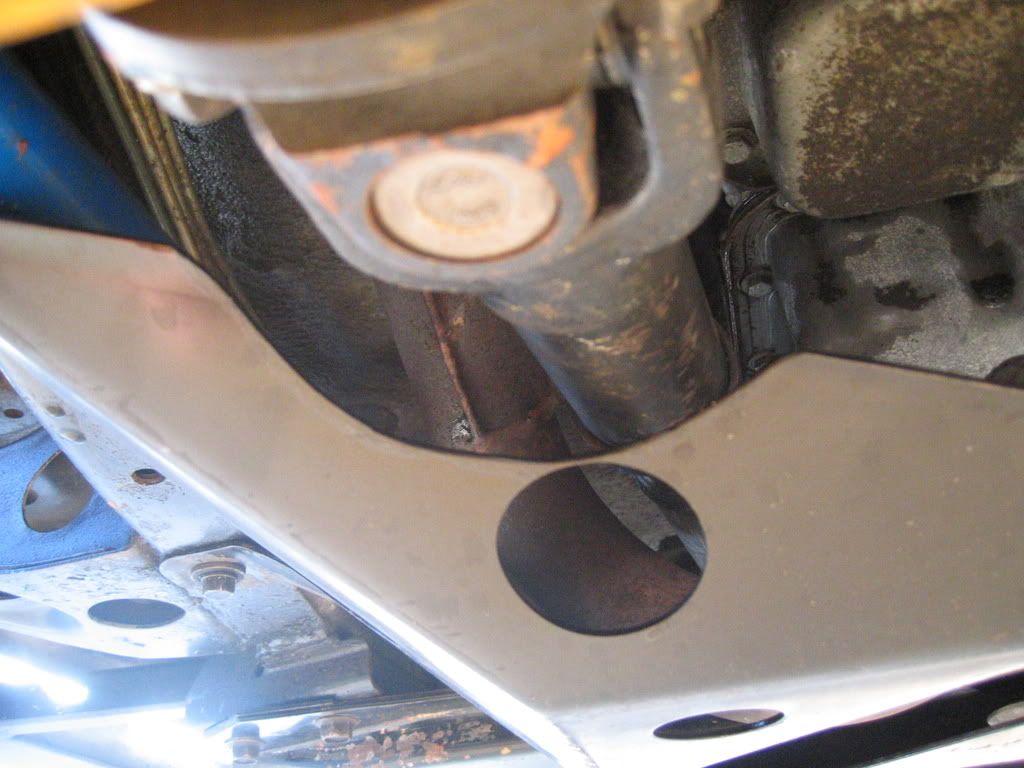

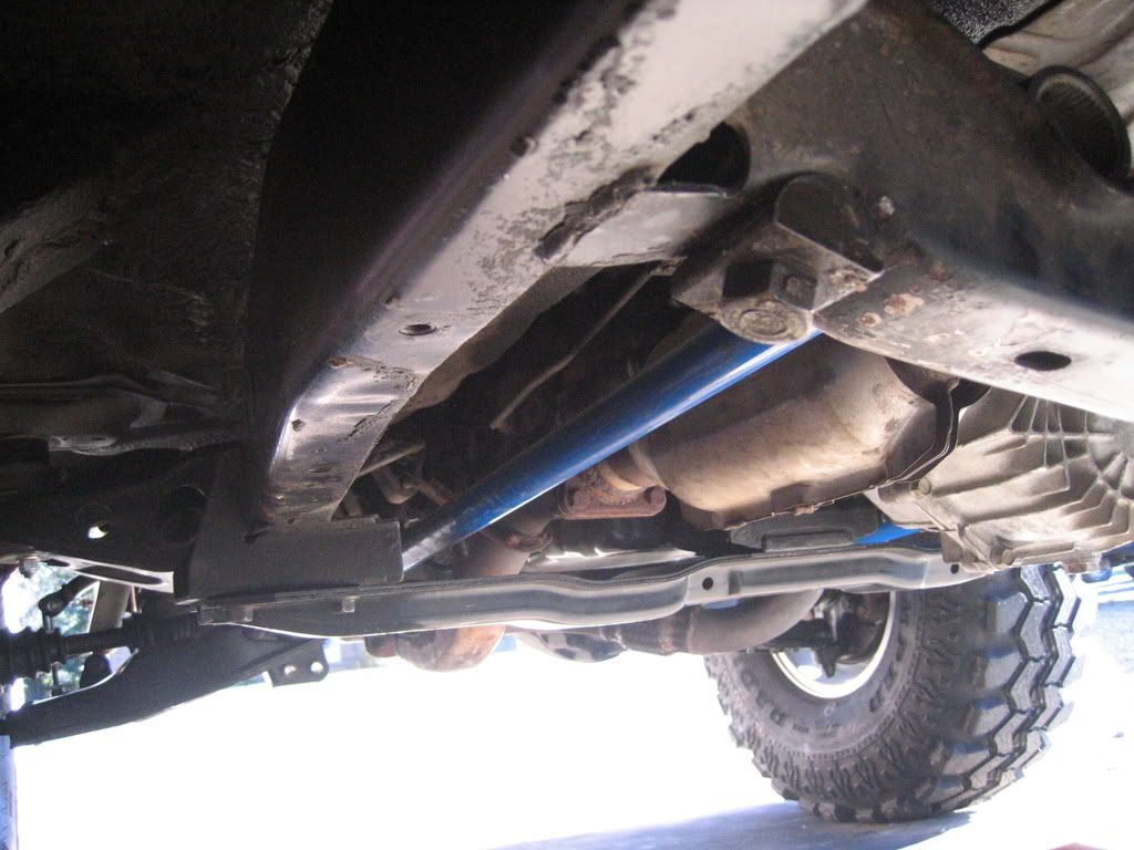

Still have to install the sub frame brace. Looks like I will have to trim a small amount of the bottom if the front fender for extreme wheeling. Does not rub driving on the road.
GRINDING DOWN THE FACTORY BOLT SLEEPS TO GET THE SUBFRAME BRACE TO FIT
DARLINGTON SUB FRAME BRACE INSTALLED. DESIGNED FOR DIFF DROP.
THE FRONT OF THE FORWARD SKID PLATE HAD TO BE CUT OUT TO STOP THE FRONT DRIVE SHAFT FRONT HITTING IT
The inner fender liner needs trimming. The plastic liner has been removed,
the next step is to use a metal cutter and cut of the tabs and pound the inner metal lip back into the wheel well. You then cut the inner portion of the outer fender so you can trim the edge and round it in with a hammer.
FENDER WITH INNER LINER TABS INTACT
CUTTING OFF THE INNER LINER TABS AND BEATING THE METAL IN TOWARDS THE WHEEL WELL, ALSO CUTTING OFF THE BOTTOM INNER AREA OF THE OUTER FENDER AND ROUNDING IT IN.
A COAT OF SPARY BED LINER AND IT FINISHES OF THE WHEEL WELL.
WHEEL CLEARANCE WITH THE TRIMMED FENDER AND TIRE STRAIGHT
WHEEL CLEARANCE WITH TRIMMED FENDER AND TIRE TURNED ALL THE WAY IN ( THE WHEEL IS TURNED OUT AND THE REAR OF THE TIRE IS ALL THE WAY IN )

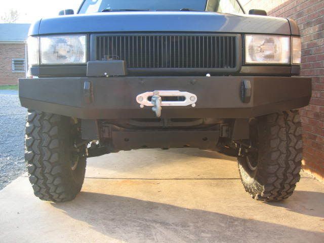

FRONT SHOT OF THE TROOPER WITH 35's
I really think true 35's are the largest you could run with IFS. It looks like part of the front frame where the bumper attaches will have to be trimmed as the tire is really close up front and would probably rub wheeling. A custom bumper bracket will have to be built.
THE REAR PORTION OF THE FRONT FRAME ( BUMPER MOUNT ) WILL HAVE TO BE TRIMMED OR WILL RUB WHEN WHEELING. THE AREA THAT IS THREADED WITH THE REAR BOLT WILL HAVE TO BE TRIMMED OFF

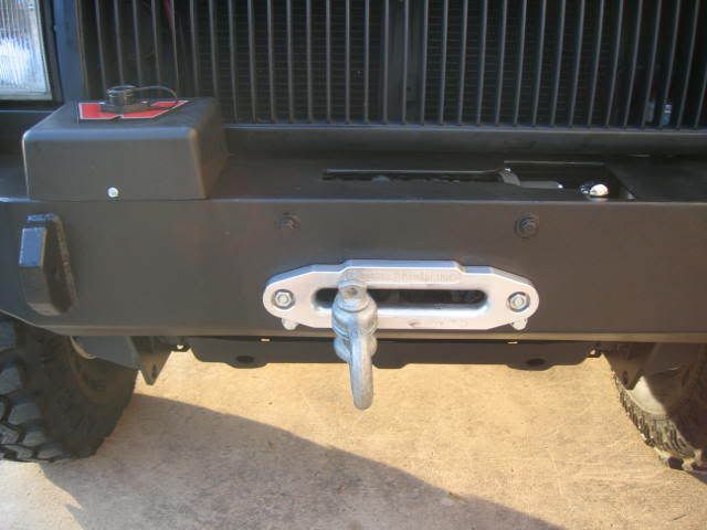

Since I managed to work out a trade with Joe Darlington, I decided to let him build the front bumper and rock sliders. He will trim the rear of the front bumper mount and make a custom mount for the bumper.
JOE DARLINGTON DID A FANTASTIC JOB ON THE BUMPER
CLOSE UP SHOTS OF THE BUMPER WITH A WARN M8000 WINCH MOUNTED INSIDE.

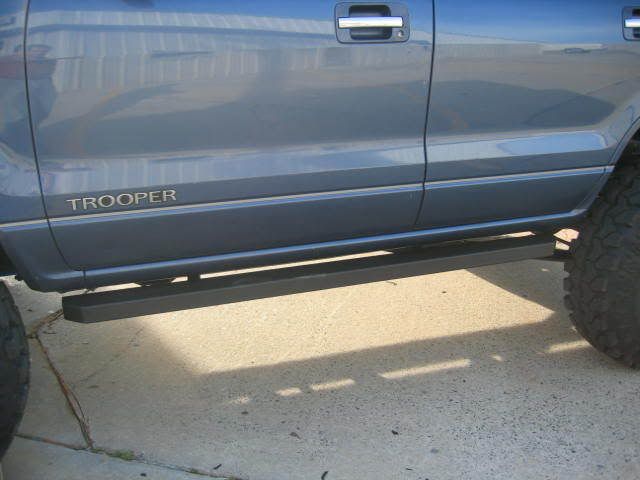

ROCK SLIDERS ARE NICE AND STURDY AND ALSO WORK AS A STEP INTO THE TROOPER
MONSTER IFS TROOPER BUILD FINALLY OVER. IT REALLY IS A MONSTER TROOPER THAT SHOULD BE EXTREMELY CAPABLE. It'S A LOT BIGGER THAN IT LOOKS IN THE PICS.
It really has been enjoyable building this Trooper. It has been a tremendous amount of work but a lot of fun. It drives very smoothly on the road and it is going for a test to URE this weekend to see how it climbs.
With IFS I think this is the largest tire you could run without any major modification to the wheel wells and front bumper frame. As it is, the front bumper frame had to be cut and a custom bumper mount made. The one inch body lift is just perfect without making the Trooper unstable. The Aussie lockers work extremely well, very easy to turn when locked up front. I prefer the front Aussie locker to the ARB locker. You can turn with the Aussie front locker and can not turn with ARB. I have found that the Isuzu Trooper is a very tough and capable vehicle and is probably the best value in a 4x4 today.

Postby RodeoRed » Fri Jan 11, 2008 5:39 pm
what did you use to paint the rear axle?

spoke to Matt at Indy4x today and he is taking my front 5:38 Ring gear to get machined tomorrow
Why does the ring gear need to be machined?
Andre

Postby gsrsol84mm » Tue Jan 22, 2008 9:40 pm
The build is coming along nicely. It always seems to take longer than you think. I had to install and remove the transfer case twice due to the difference between a rodeo and trooper shifter. I am just waiting for the front 5:38 gear set. Matt at Indy4x has it at the machine shop to get the ring gear machined to accept a spacer. Looks like the 10 bolt 5:38 gear set's were made for the older Isuzu rear ends and have to be modified for the 10 bolt front ends. I have been waiting to do the whole suspension swap at the same time I install the 5:38 front gears and do a diff drop.
To answer a couple of questions: I paid $700 for the trooper and used ultra flat Krylon to paint the rear end.

Postby Tad » Wed Jan 23, 2008 11:21 pm
Psst, your cat is in backwards.

Postby DRaider90 » Thu Jan 24, 2008 2:04 pm
I know tires may not be the focus of this build but my question is are those SSR Radials or TSL Radials?
SSR
VS
TSL
Taking note of the sidewall design/pattern.

Postby gsrsol84mm » Thu Jan 24, 2008 11:39 pm
They are the Super Swamper Radial. They don't make the TSL Radial in 35's. There was not a whole lot of choice in the 35-10.50-15 sizing.
Interco is coming out with the LTB in 35-12.50-15 which will be a fantastic off road tire. 12.50 width is harder to fit than a 10.5 width with an IFS tortion bar crank.

Postby isuzufool » Mon Feb 25, 2008 1:08 pm
I don't mean to be negative, but it looks like that catco converter is installed backwards!

Postby gsrsol84mm » Sun Mar 09, 2008 8:12 pm
Finally got the 10 bolt ring gear machined for the spacer yesterday. It has been a long 3 month wait. The build is back on track. Thanks, I know the cat is on backwards.
