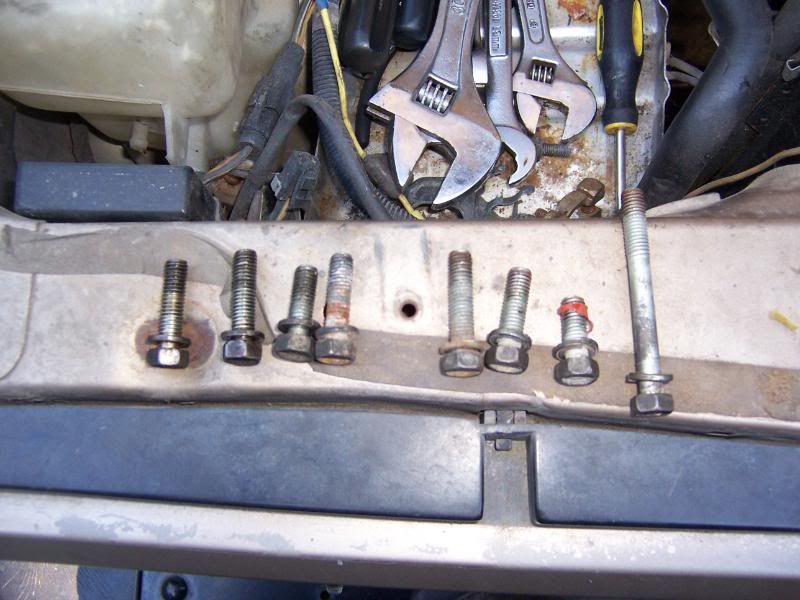

Oil Cooler
Trooper bracket on left:
The pressure relief valve nut is too big on the Impulse bracket and hits the mount bracket. So I swapped over the smaller Trooper nut and spring. Still a tight fit, I'll add a pic tomorrow.
Also of note is the bolts are different between the 2.
Impulse bolts on left:
