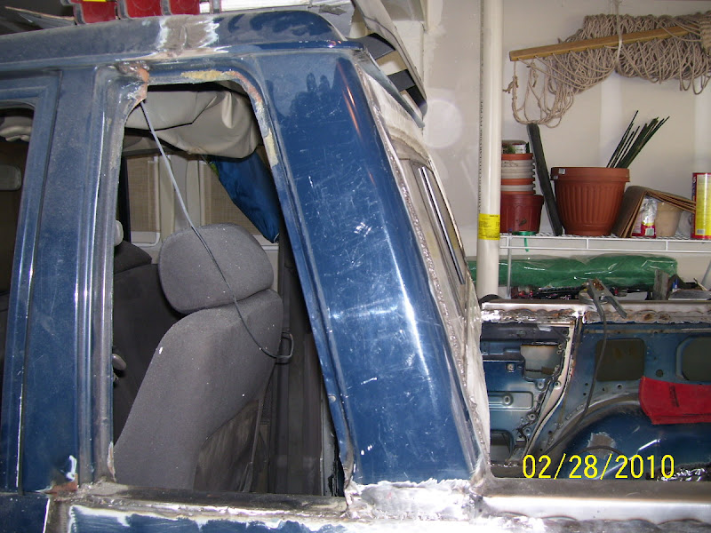

Postby VX1032 » Sun Apr 11, 2010 2:55 pm
Okay, this is a lot harder than I had hoped. The pickup rear wall does not fit that well, but works. The pickup is 4" wider at the beltline than the 1st gen trooper. That causes issues with the fitment of the rear window. I lucked out to where the recess portion of the window cut out "JUST FIT" between the rear corners of the Trooper. I did have to cut the pinch welds off the sides of the trooper door frames, what the weather stripping once attached too. That was actually visible through the rear window, so out they came.
I still need to weld the top of the rear section up, but the pickup curves too much in there so I need to overlay a piece of sheetmetal from the top down an inch or so to weld it in.
The rear section of the pickup is slightly curved, like the rear window, so I will have to make a transition with the body filler and after I grind the welds down. It is amazing how square the trooper really is.
(yes Lowzone, I put a flat edge on the windshield and it is perfectly flat, no curvature)
I am not going to post all the pics here, but you can see below how it looks now with the window just set in. More pics in my picasa gallery below. Also shots of how much room there is from back of drivers seat at top to rear window, and how I squared the floor of the trooper up to accept the lower portion of the rear wall. Please do not pay attention to date stamps on the pics.

Postby VX1032 » Sun Jun 06, 2010 9:10 pm
Rear wall is welded in and ground down. Next is to move on to the bed sides.
I even moved it out of the garage for these pics.

Postby VX1032 » Sun Aug 29, 2010 4:51 pm
I am finishing up the passangers side rear and I have an issue I want to run by all of you. On the rear passangers side there is the bump out for the fuel filler neck. Also, behind that area is a few connections to the gas neck and one electical connection for the rear brake lights.
I was going to just make another cut out like I did on the driver's side, but I think their may be a few issues. First, to make it work, I would have to make it larger, and then to still gain access to this area I would need to unscrew the cover for this area. That covers screws are completey rusted and probably won't come off easily, along with it being attacdhed with that sticky foam.
I could make the cut out go over the cover, and then "if" Iever need to get to that area I would have to unscrew the cover and then deal with that cover.
Or
I could ditch the whole cut out, work the new panel I have to put in behind the cover and into the gap caused by the foam, and then "if" I ever have a problem, I would have to jsut deal with the cover.
The second would look cleaner, but would be harder to do, and I fear about welding so close to somethign that is supposed to be removed at some point, possibly.
Which way do you think would be best?
Ryan Christiansen
(sold) 99 Vehicross 1032 OME 912's, Stric9 Sliders, Definity Dakota MT 285/75 R16, Aussie Lockers Front and Rear, 4.77 gears and Warn Premium Manual Hubs.
(sold and purchased Back) 88 Trooper 2.6 Auto with Snowflakes and 235/85's, and a pickup bed! In progress
https://photos.app.goo.gl/aonWS8uuo8cRZMzJ8 Album 1
https://photos.app.goo.gl/3BMo6pGyUy9Mee7DA Album2
VX1032
Posts: 480
Joined: Tue Jun 24, 2003 8:21 am
Location: Grosse Ile, MI
Postby VX1032 » Mon Aug 30, 2010 7:40 pm
It came to me in the shower, the solution I mean.
I just took off the cover and made the cover the access panel. I have cut out the panel and will weld it up, leaving the area behind the cover, minus a half inch for access to the filler neck and wiring.
I figured the foam seal that the cover already had was not water proof since it was meant for the inside, not outside of the vehicle. It is better to deal with the drilling and retapping of the cover now, than after everything is finished as well.
