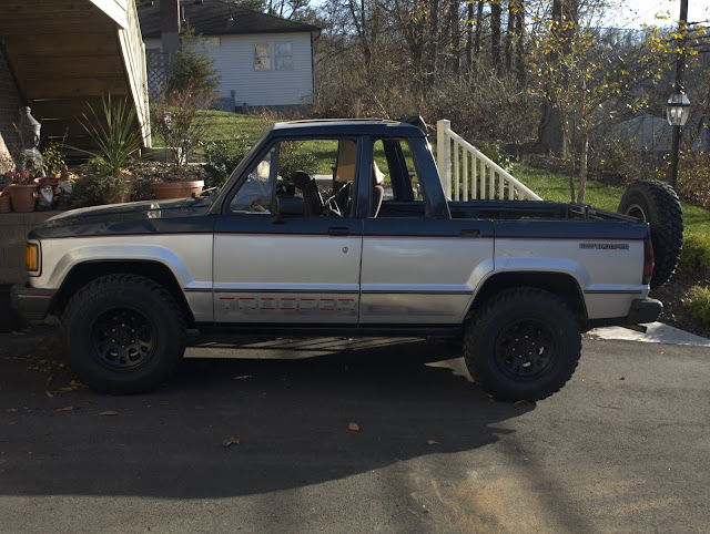

Postby VX1032 » Tue Nov 24, 2009 4:26 pm
So here she is as she sits now, except for the broken tranny pan bolts, and the piece of exhaust missing, she is ready to start the body work, or finish, since the top has already been chopped. I will keep everything in this thread so you can all stare in wonder at my trials of learning to weld.
Have to lose about two inches in the rear window area for my tastes, but that's my baby!

Postby TonkaToy » Wed Nov 25, 2009 5:24 am
That is one hell of a project. So what is the vision for this machine?
For your comfort I would try to pick up a set of used Jeep softtop windows and cut them down to size and install snaps so you can try to keep some of the heat in in the winter. Besttop sells a kit just for repairing or replacing softtop snaps. I still have mine from my Jeep days.
Good Luck!!

Postby VX1032 » Wed Nov 25, 2009 11:46 am
Once the rear section gets welded on, I need to build a rear wall to seperate the cab from the bed. I have a rear pickup window from a 91 pickup that will go in as the rear window, and the side windows will be glass, cut down from the existing windows I took from the trooper, well I hope. If I can't I might just sheet metal over it and make it a big B pillar, that would be easier.

Postby ZOMGtrooper » Wed Nov 25, 2009 1:47 pm
looks nice. Are you going to weld up the rear doors?

Postby Metal88 » Sat Nov 28, 2009 12:04 pm
thats awesome! this one looks more original than other troopers ive seen with the roof chopped off. it looks clean also.
im guessing your thinking on a roll bar?

Postby VX1032 » Mon Nov 30, 2009 9:42 am
Sticker space would be pretty big!!
Actually, at the moment I am not thinking of a roll bar, but I won
t rule it out. there is a lot of beef in the D pillar and it is close to the B pillar, though it does rest on the door that isn't all that reinforced, so that might be the solution instead. Not sure yet.
Yes, doors are getting welded shut and eventually you won't know they were there, or that is the plan.

Postby VX1032 » Mon Jan 18, 2010 4:19 pm
Pictures below of the progress this weekend (today). Seems like I am out of town every weekend, so thank god for days off. I think I got a little high from the fumes from the work this morning.
Don't pay attention to the dates on the pictures.
Left Side C pillar, old D pillar, welded in.
The next two pics are the sheetmetal piece I had to cut out and weld in to seal off the rear door. Now there is no access to the rear door hinges and it will be a cleaner door jam for the driver's door. The pictures don't give the lack of room to the rear weld justice. It is tough getting the MIG torch back there. Welds on the front seam are looking better.
There rear portion of this rocker had a piece of silver tape, bondo, and blue spray paint that hid the hole in the rocker. I knew about it so I knew this patch was coming.
What I didn't know, was that there was a hole here. While welding the bondo just kinda krinkled up and the wire brush exposed this. That will be next week. But on a nicer note, that line of spot welds is looking much better.
Now I just have that hole on the rocker to fix, fill the door handle in, and then grind grind grind. Once that is done, I can flip the truck around and start work on the passengers side.
I remember some one saying use an 86 2dr to start because it would be a lot easier. I wanted the AT tranny, and axles from an 88 instead. I am beginning to think it might have been easier swapping the axles and tranny. Oh well. My first roll of welding wire is just about up, second bottle is 2/3s gone as well.
