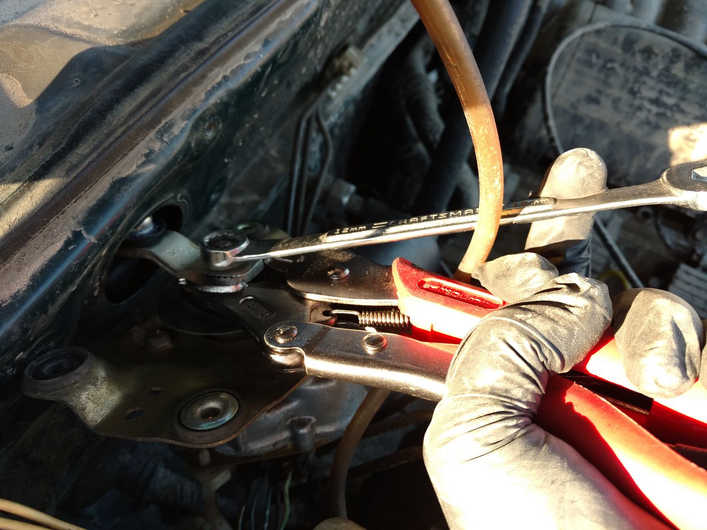

When I first bought this truck, I didn't touch the wipers until it rained, about a month later. It was then I discovered the relays in the 'ALARM' box were shot, so I had two speeds and no rear anything.
Also, the middle connection on the wiper linkage popped off, disabling the driver side wiper. Arguably the most important. The plastic cup that seats the metal ball no longer had enough...whatever to grip the ball. I made a band-aid that held for 3 months.
Anyway, with the very recent rain fall, quite heavy, my wiper band-aid broke. I went through 16 zipties in 3 days, constantly pulling over and re-ziping the fix I made.
New linkage was ordered a couple days ago, and here's that:
When I started the swap job, I intended to take pictures of every step.
I took two....
Taking it off:
Putting it on:
The longer you leave a thorn in your skin, the more you'll appreciate removing it. The frustration of the driver side wiper constantly breaking my zip-tie fix, was incredible. But now, oh it's so nice. Brand new Dorman linkage.
