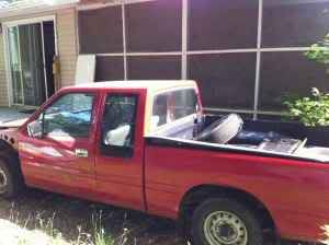

just got a 93 spacecab base model 2.6L 5spd w/AC. hit in front, frame has one hole in the back that is repairable. anyway im going to fix the cab in the front where its hit
sold the bed to another NJ member.....so i have a cab on a frame with a bad back section and a long bed frame section that would weld just in front of where its rotted....problem solved....and the result with help of MS PAINT (used my other Spacecab i got from Joe D for the model as its a perfect side shot)....and Voila'

this is how i got her.... :(
