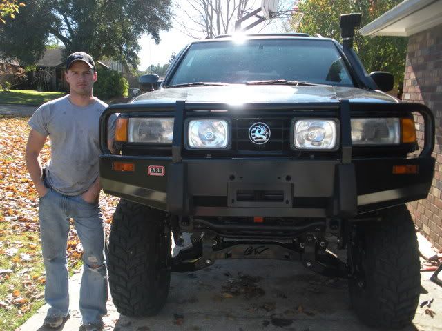

I had this lift imported from Thailand, it was very pricey,but it's detailed and very simple to install. Right now im sitting somewhere between 13 and 14" of lift. This week im getting tires, haven't decided what size yet, today im test fitting my buddies 36" swamper to see how it looks.
Im running 4.78's which should be plenty for what I do.

Are you maintaining the IFS or going SAS?
I like the look, is there a specific OHV park or style of offroading you are purposing the Rodeo for?

It's staying IFS, a solid axle would never get used for it's purpose in my book. Around here there's no reason to do a SAS. I have a friend who did it and to this day it's never seen off-road.
She's a street queen and Im not ashamed to admit that.

I had it custom made in Thailand. Mine is the first kit they produced.

This kit is bulletproof. Very well designed, and the simplicity of it is unreal. Another cool thing about this lift is the spindle, it gives alot of positive camber to make up for the angle of the lower control arm. My ball joints are at stock angles. :shock:
2,854 Posts
Complete kit, new spindles, crossmembers, sway bar links and drop brackets, track bar brackets, etc. Almost everything is dropped, and the best part is the t-bars stay in the stock location. There are brackets that allow this.
