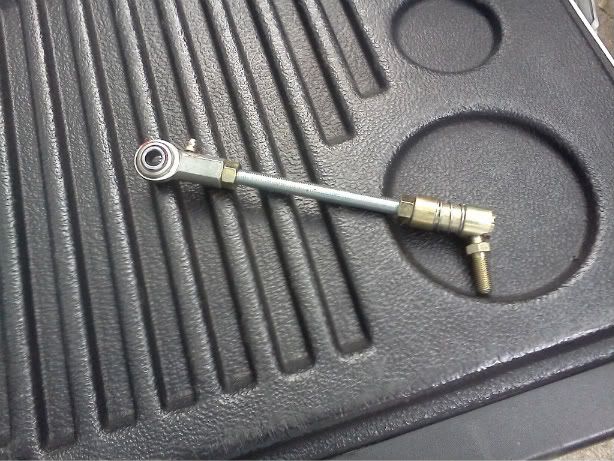

I fabbed up a set of quick disconnects this afternoon after getting tired of my sway bar rubbing on my shocks. They have a greasable heim joint on top and a quick disconnect linkage on the bottom for easy release, and they are a little longer so they don't rub on the bar. I was wondering if anyone would be interested in a set, let me know.

Like this? If not, take a picture and I can probably come up with something.

How difficult are they to connect/disconnect? What do you do with the swaybar and links when disconnected? Sorry for the questions, my front sway bar has been sitting in my garage since I bought the truck.

I have some of the old Indy4x disconnects on front. I disconnect and then velcro strap the links back to the sway bar to keep them out of the way. Then I bungee the sway bar to the shock tower on one side, such that the sway bar is in approximately the same place it normally is. I have found this to be the best place to keep it from rubbing on anything. Probably not the best system, but it seems to work OK.

I do what BigSwede said as well when I disconnect them. They aren't very hard to connect/disconnect. The tolerances are still pretty tight now, but I greased up the disconnect stud and it isn't too much effort to reattach them.

I started to develop a lot of play in the quick disconnect in the original design, so I replaced it with a heim and a bolt with a hole for a cotter pin. This design is working well and is noiseless as far as I can tell (bad ball joint). I will take some pictures of it tomorrow.
Cool, thanks. I'll check the pictures. Please send me the arrangement details to my PM.

Here is a picture of the new disconnects. Price might be bumped up to 70, because the bolts on the bottom are pretty pricy. I will do some number crunching and find out for sure.
