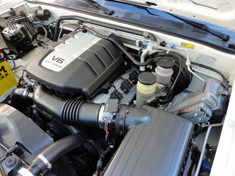

I thought I'd post this while fresh on my brain. As part of the preparation for my annual emissions test, I've replaced the under hood vacuum hoses with silicone hoses. I ordered them, by the foot, from Hose Techniques.
My 2001 Rodeo V6 used the following sizes and lengths to replace all the under hood hoses. This does not include the evap hoses that run to the rear of the truck:
Diameter - length:
3.5mm - 8'
4.0 mm - 2'
6.0 mm - 4'
I ordered black and reused the stock protective shrouds. This keeps them from being obvious and they seem seem to work well.

It only looks this good because I power washed it last week in preparation for the emissions inspection. I was up Rampart Range a few weeks back and it was crusted with oil/dirt and grime. You'd be suprised wat $10 at the local car wash can do.

I always clean it before I work on it. She was running rich and blowing black smoke at WOT without any CEL codes. I replaced the MAF, coolant temp sensor, air filter, cleaned the plugs, cleaned the EGR and installed the vacuum hoses above, all to try and get it through the emissions process.
On a positive note, she passed with flying colors. Hydrocarbons and NOx were down over her last test (in 2005). CO was up from 1 to 6, making me think my CAT's may need to be replaced before the next test.
