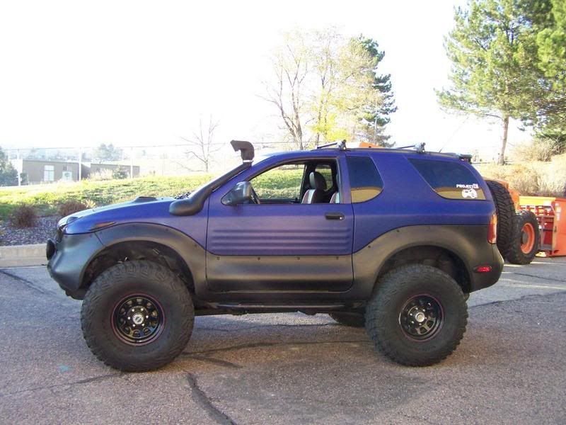

The First Picture July 2009
November 2012 :D

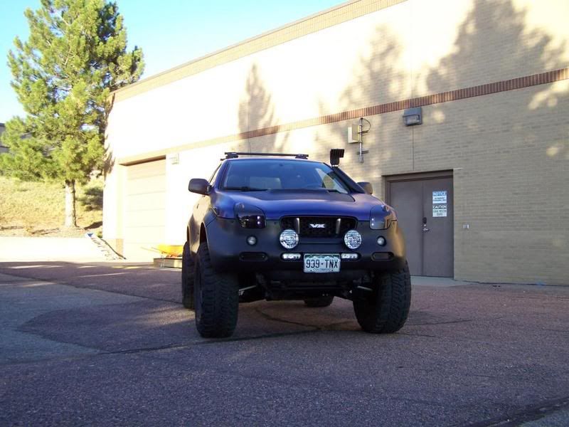

Project ZU Modifications
*Project ZU is just my fun way of saying designed and built by me. Most of the projects take forever to finish because I'm usually figuring them as I go along.
Rear Tire Carrier
Description: Tailgate flattened and built to carry a 35" tire.
Working time: 6 months (on & off)
Link: http://www.vehicross.info/forums/showthread.php?t=21800&highlight=rear+tire+carrier
Headlights
Description: LED Daytime Running Lights built into headlight bezel. Additionally, I installed Morimoto D2S projectors, 3five 35w ballasts, 5000k bulbs and blacked out reflector. Gun Smoked Lamin-x applied to lens.
Working time: 5 months- mostly design
Link: http://www.vehicross.info/forums/showthread.php?t=22202
DRLs
Headlights On
Close-up

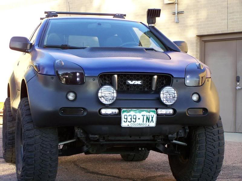

Hella 500 Driving Lights
Description: I wanted Hella Driving Lights embedded in the bumper for a clean look. I used a 4 foot piece of fiberglass unistrut as an internal light bracket because the unistrut fits perfectly between cladding turn signal & OEM round light. Next, I carefully cut out a shape for the driving lights and used a mounting bolt to secure the lights to the unistrut.
Working time: 4 hours
Hood Insert
Description: I wanted to add a functional heat extractor to the hood insert. I used a reverse hood scoop sold aftermarket for the Subaru WRX/STi. I fiberglassed the reverse hood scoop into the insert and had the insert professionally sprayed with Line-x
Working time: 8 Months (on & off) - first fiberglassing experience and I kept improving the quality over time.
