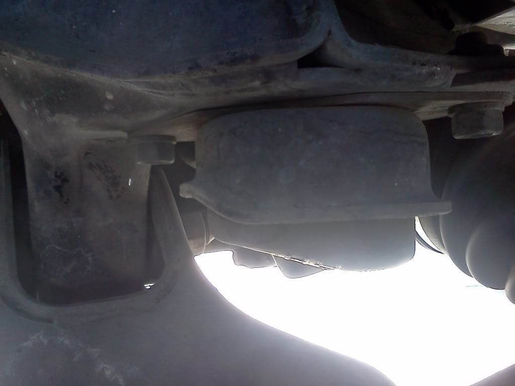

hello quick question about the rubber stoppers now where is it exactly? here is a picture what I think where it is but not 100% sure can some one help point the way. thank you.
is this it?
Kentjoecoo said:
That is a bump stop yes. What you doing with it?
I'm replacing it with independent4x rubber stopers just makeing sure its the right one before removing it. anything i need to know or advice? and thank you.

depends... link to the bumps you bought from Indy? there is a low pro down bump... the one pictured is the up bump.
8,073 Posts
Yeah that is a compression bump stop pictured, not the one you generally want to replace. The droop bumpstop is in the middle of the upper control arm.

middle in the upper control arm ok
8,073 Posts
Kentjoecoo said:
No worries. The first time I tried to install low profile bumpstops I mistakenly unbolted the compression bumpstop... That's how I knew from the pic that he was looking at the wrong one.

actually the stock bumpstop are smaller then the Indy bumpstop. indy is a bit bigger then the stock one that I had heres some pictures. I don't know all isuzu have the same size bumpstop?
3,587 Posts
^^^Mine were the same... but I have the long arm suspension. Maybe the tall ones are from the short arm gen 1?
