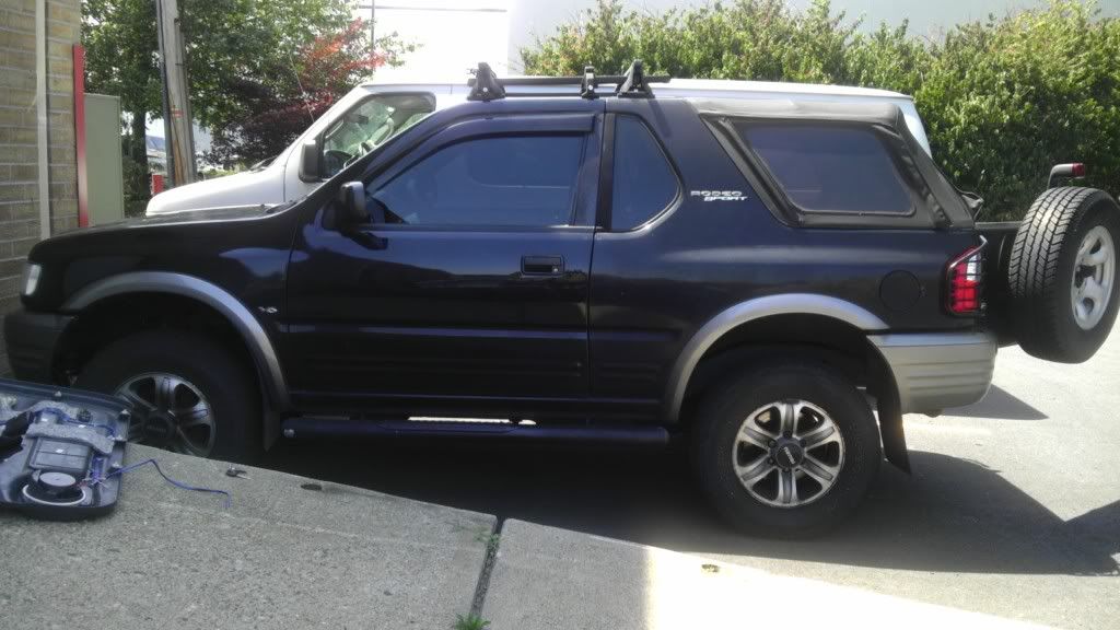

Window Tints - DONE
Plain ole tints to help get GF approved. I tried using that roll on static cling stuff from Walmart, but it kept coming off.I had the rear soft top windows replaced with charcoal vinyl (by the same upholstery place). The shop cut out most of the clear window and sewed the charcoal vinyl unto where the clear window met the black soft top. The front tints were matched to it, I believe they were 35-40%, I cant remember. Ultimately, the GF cant take all the credit here - a local thief helped me determine that I needed new vinyl windows - the front tints just seem like a given. If I had to do it again, I'd just replace the whole top with one of those EBAY versions with charcoal windows.
Total cost: $300 (3x back windows + front tints + static cling stuff)

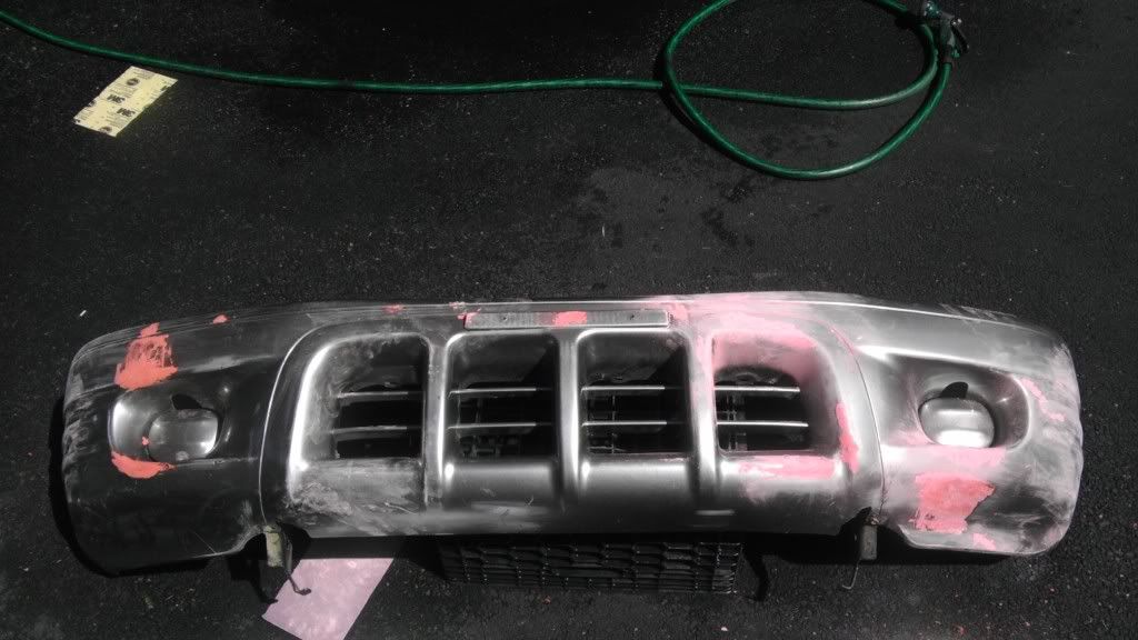

New Front Bumper w/ Extension - In progress
Long story short: A lady was parallel parking, got out of her car to remove a glass bottle, stumbled out while the car was in gear, grabbed the steering wheel, managed to get pinned underneath her Altima, and careened her vehicle into the front of mine - which was on the OPPOSITE side of the street. Lucky for her that my car was there, otherwise she was heading into heavy traffic. That is one hell of a story, couldnt even make it up if I wanted to.
I never bothered to fix it, until now. You can see the hideous ebay halo foglights in the picture. We were all young and stupid once, right? I bought a used bumper in 'rough' condition on ebay, but it was complete with brackets and reinforcement bar. I would need to fill in the scratches and digs, the middle extension + grille guard will cover a lot of the imperfections.
Before/Current:
The extenion was previously removed, to get painted.
Bumper Prep:
Extension Prep:
I had to fill in these large gapping cracks, luckily it made the verticle bars bow out and cover much of the damage.
Extension Primered:
The repaired bumper and extension are done, I'll take some after shots for you guys. This is the first time I've done any bumper repair and painting, and while it isnt the greatest job ever its definately better than whats on the truck now. The paint was grabbed from Paintscratch.com and was rattle can applied. They offer a good match, it just takes FOREVER to receive the paint.
2x Titan Grey - Bumper
1x Bright Silver - Extension Piece
2x Rubberized Primer
2x Clearcoat
3x Rubbing Compound
More 200, 400, 600, 800 grit pieces of sandpaper than I could count......... RIP little guys. :sad1:
Before and After pics - waiting on finishing my AC compressor and Transmission Cooler install before mounting the bumper
Total Cost: $50 (ebay bumper) + $130 paintscratch.com = $180
