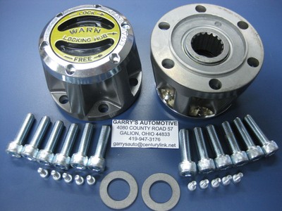

11,763 Posts
Rim Household hardware Bicycle part Circle Automotive tire
The issue addressed by the originator of this post is why the Manual Lock hubs for sale are not applicable to 2000 and 2001 Rodeo. This is an image of my 2001 Rodeo 17 spline drive plate, it looks like the Manual Lock hubs will fit. The same CV joint fits 1998-2001 Rodeo.
