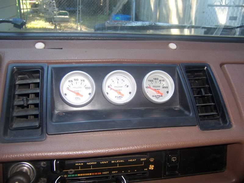

After going through the wiring for the gauge cluster and a couple of clusters I decided to put in some autometer gauges.

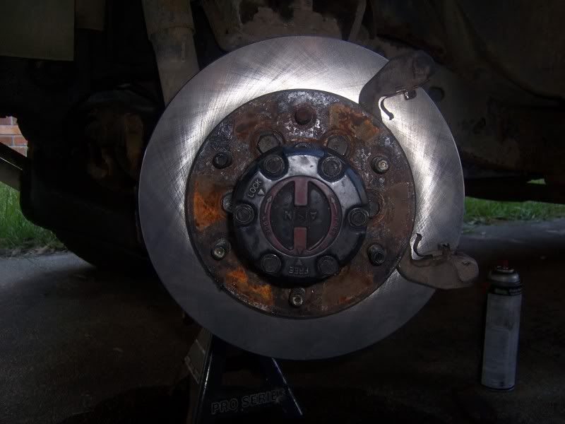

I'm also swapping the front brakes for the 2nd gen setup
Also have on hand some Aisin Manual hubs to replace the auto units.

The water temp needs an adapter to fit in the lower intake. Part #ATM-2268. The oil gauge is pretty straight forward, just swap out the pressure sensor on the oil filter adapter and run wiring.

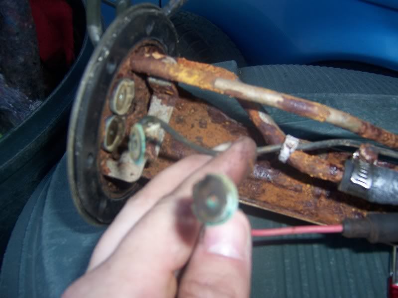

The gas gauge is a bit tricky. Isuzu didn't use the same resistances for its float sensor (in the tank) as GM, Ford or Mopar so I got the gauge and matched Autometer sendor together, I'll post the part #s later when I get the chance. The autometer sendor even uses the same 5-bolt flange as the factory, just gotta get the sendor positioned properly so it'll read right.

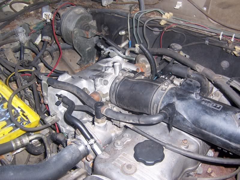

And the bigger 2.6L intake/MAF from a 93 Rodeo:
