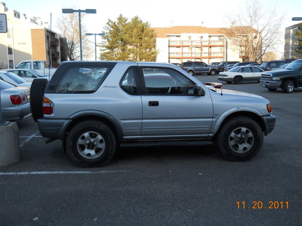

'99 Amigo with 245/75/16 Warden (C). Just got them mounted this week. I had to lift the front up about 1.5" (which is about how much it was sagging) and I had to trim the rear of the front fenders about 1" at the bottom. The fender covers are off in the picture, but I can still put them back on. The issue is that the Wardens are so square on the corners.

Well crap. I'm *really* trying to avoid doing any kind of trimming and I guess that answers my question about the Warden's fitment. Anyone have the Hankooks on a 2nd gen?

Enemigo, I'm wondering if you have on yours because of the stock wheel. From my understanding, the stock 16's for 2nd gens all have a 4.5" backspacing vs. 3.75" backspacing for the older wheels and snowflakes. That would cause the tire/wheel to sit a little further out of the wheel well and might give you a little extra clearance. I scored some of the 16" snowflakes from a Passport and that's what I'll be putting tires on. I just have to decide on tires, which is proving to be a more difficult decision than I thought.
166 Posts
Sorry, I had a bit of a caffeine buzz when I wrote that. What I meant to say Enemigo, was I wonder if the rubbing you had w/the 245's was due to the stock wheel's backspacing. the size chart is based on the older wheel's backspacing of 3.75".
