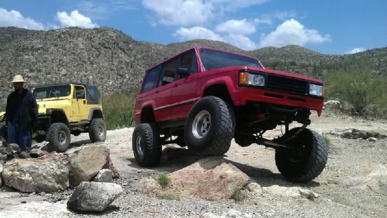

here's a few pics from the previous owner (see if u can recognize)

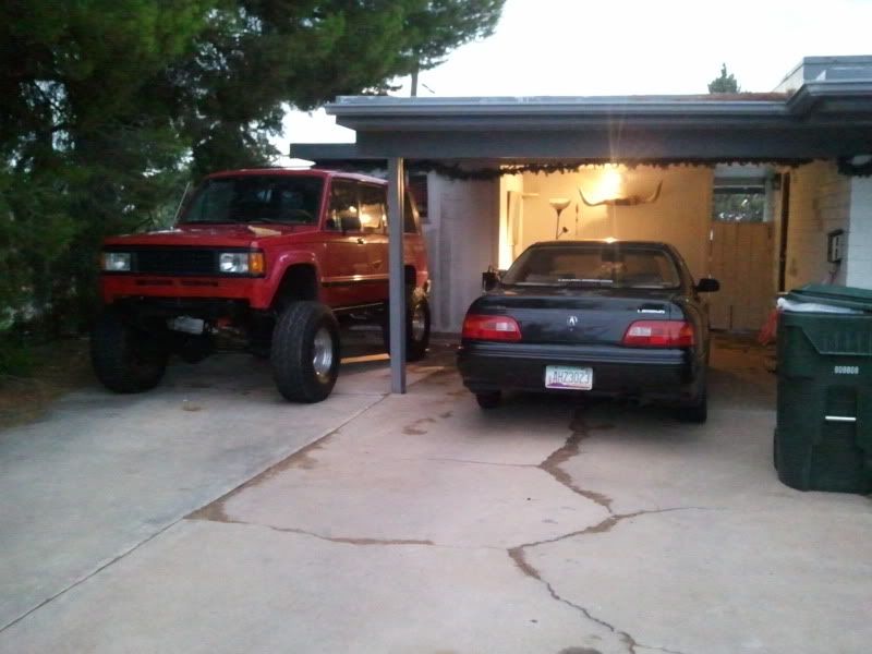

next to my wifes 93 legend
