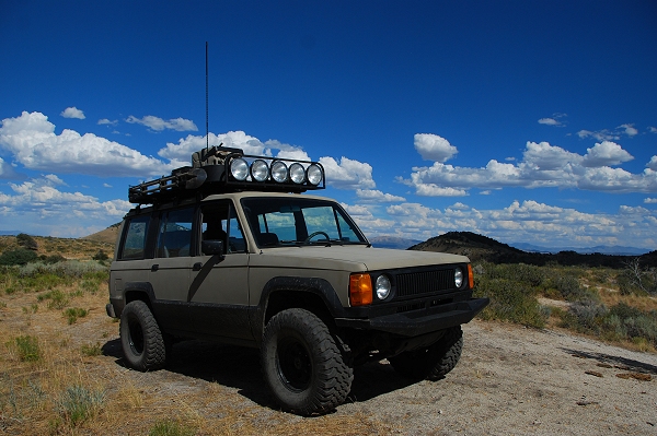

I am also building mine towards this idea.

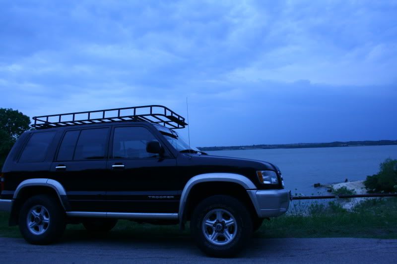

I have OME 919 Springs that provide about 1.5 inch of lift. I have no desire to go higher. I currently have 31" A/T Tires, and will likely upgrade soon, to nothing larger than a 33".
My Roof Rack is ungodly large, but it offers carrying a 2nd spare tire, some parts in triage cases, spare gas, my high lift, I will also be sleeping up there, have not remedied that yet.
Will also be making a rear platform for storage and sleeping inside.
As previously posted, however, mechanical reliance of the vehicle is number one. These cars can take on a lot at factory with slightly larger tires. But, often these trips mean driving several highway hours before reaching a sever hour/day off highway adventure.

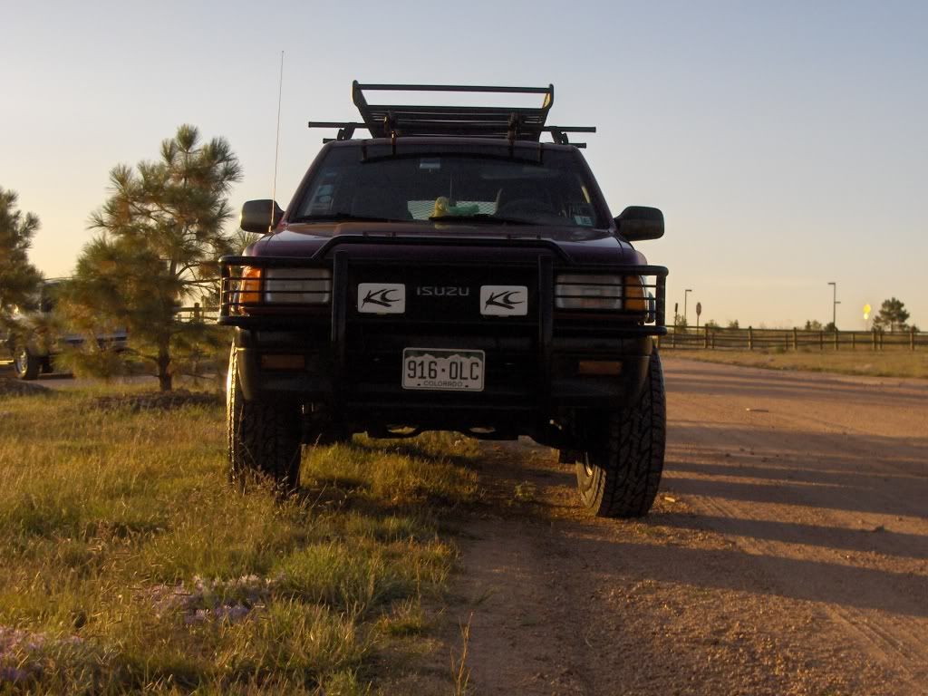

I built up my Trooper as an expo rig as well. You do not need a body lift. Really you can get away with no lift, but a mild lift is nice and will allow you to get over more rough terrain. There's no reason you need to go higher tha 2 or 3 inches for an expo rig. Just enough to give your belly some extra clearance while allowing for some bigger tires. Remember, you don't want to stress your CVs too much. And rock sliders would be nice, depending on how hard core you get.
Here is a list of stuff I think every expo rig should have:
1 ) Roof rack
2 ) Mud Terrains
3 ) Manual locking hubs
4 ) Locker
5 ) Spare gas carrier
6 ) CB
7 ) Offroad lights
8 ) Winch (still need to install mine)
The most important thing though, is the driver and a desire to explore!
