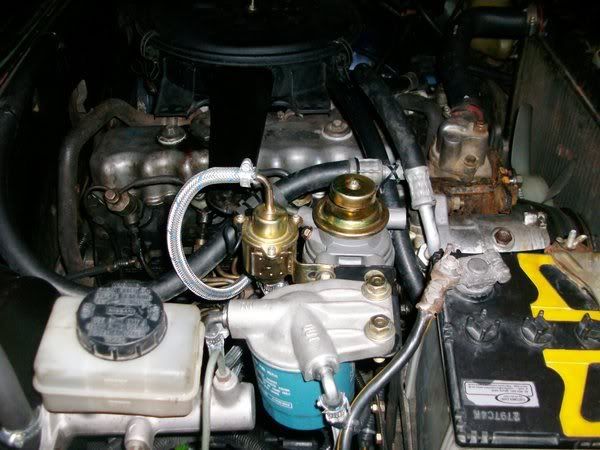

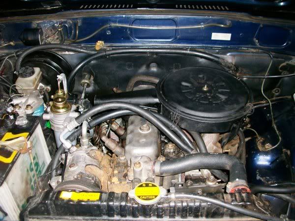

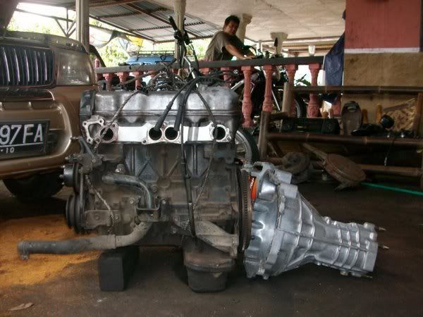

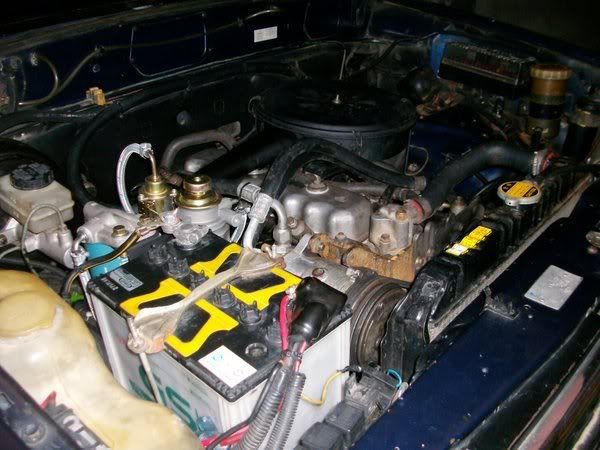

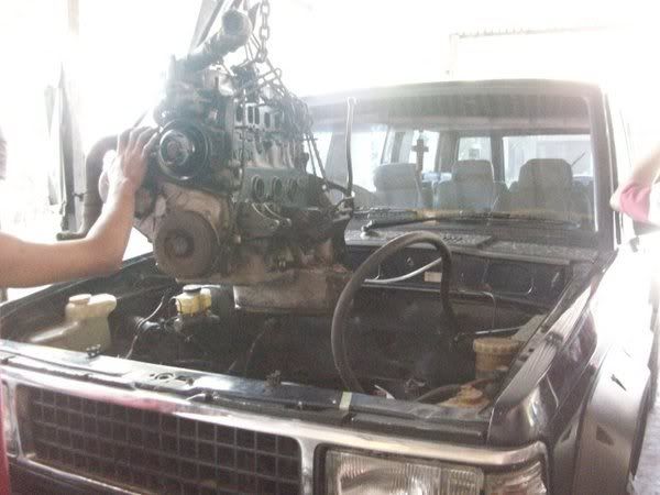

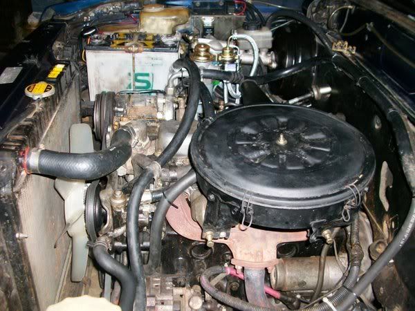

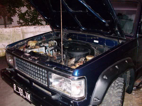

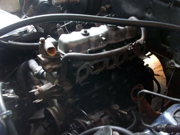

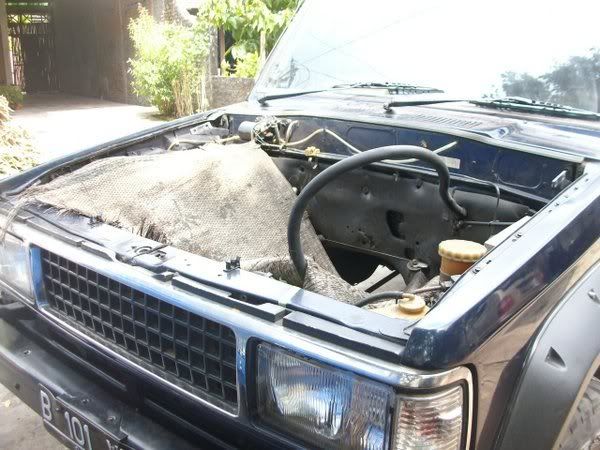

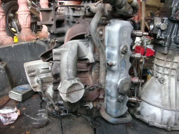

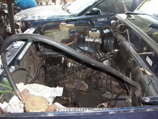

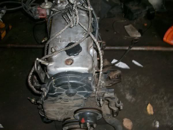

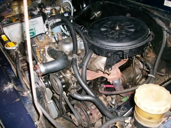

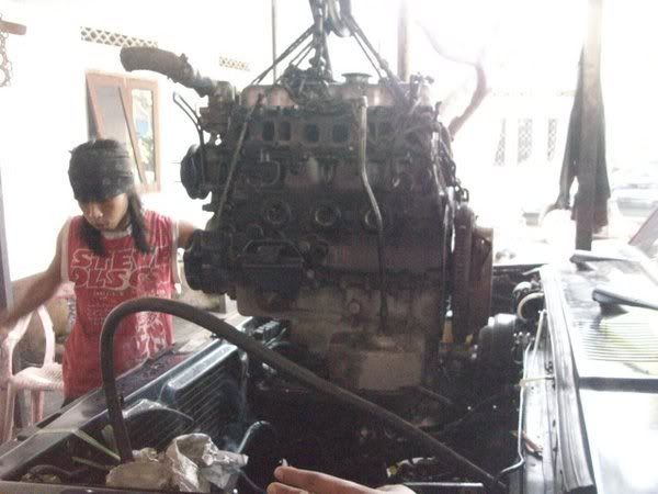

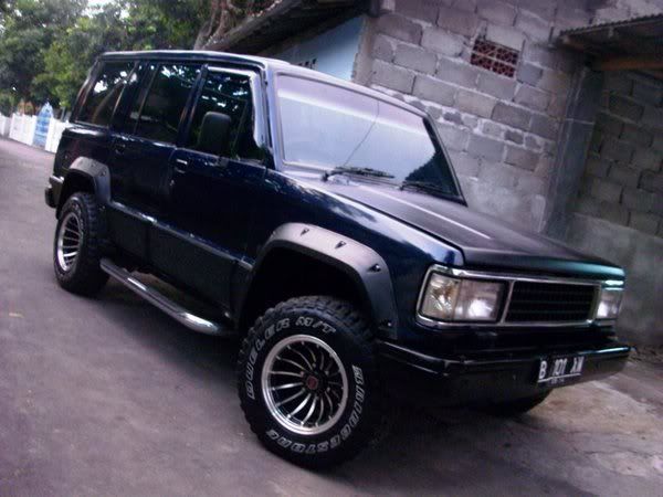

work for fun swap of gasoline eng.4ZD1 (carburetor) to diesel engines trooper .... use diesel c223 made in korea ..., but the transmission bell housing must be replaced with a diesel engine transmission .... more make the bracket air conditioning, power sterring, diesel fuel pump stand & adjust length of the front & rear propeler shaft
end in success ...ready to Mud :)
The attached photos
old engine
new engine

skrait jealous 8)
501 Posts
ervan
Very nice work. My hat is off to you sir. :)
