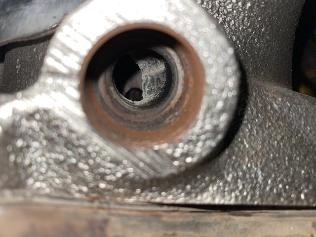

That looks like carbon buildup to me. Have you tried to attack it with a small screwdriver or other suitable scraping tool? I bet it crumbles away.
Since you're borderline-fail, anything that blocks the normal amount of recirculated exhaust gasses might throw the emissions test off.

So I totally forgot I have an endoscope. What a good time to have one.
Here's a close-up in through the EGR port:
And here's a view from the O2 sensor port:
Looks like that's just part of the manifold. Hitting it with a screwdriver, it feels pretty solid.
