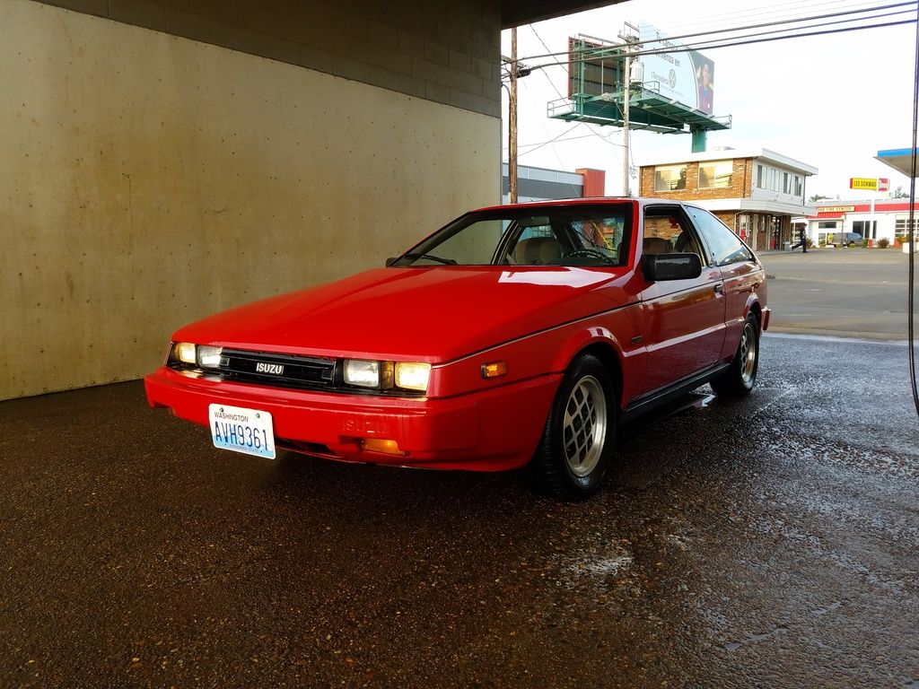

Okay so I finally found an impulse near me for a reasonable price so I went and picked it up

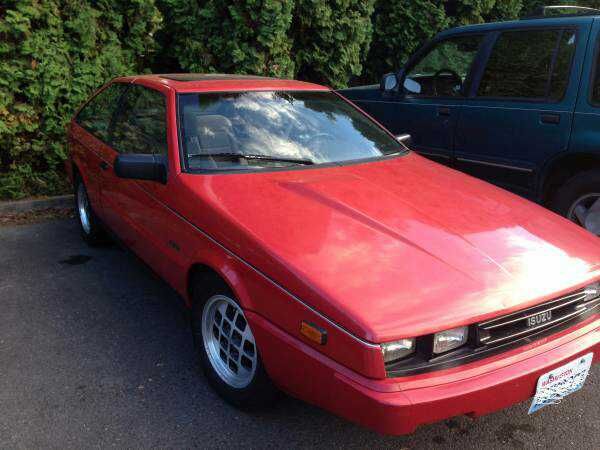

It is a 1989 with a 2.3 and suspension by Lotus

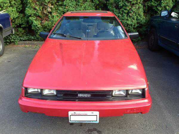

This is how I found it, with a massive coolant leak, barely running on 3 cylinders. Other than that it was in great condition! The leak was one of the coolant hoses going to the throttle body. A quick bypass fixed that problem. Swapped plugs, wires, and cap out and it ran perfect.
$450 later and the impulse was mine. Truely a steal

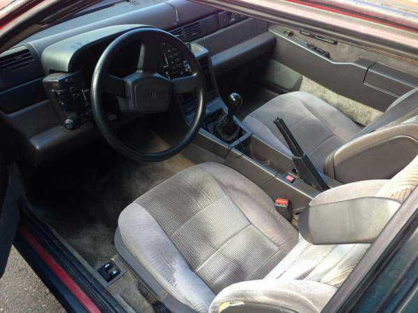

SWEET!!!!!! Looks to be in real good shape. Obviously has early Trooper / Rodeo steering wheel. Sunroof is probably the same too. Will be a real Isuzu hot rod. Dennis
