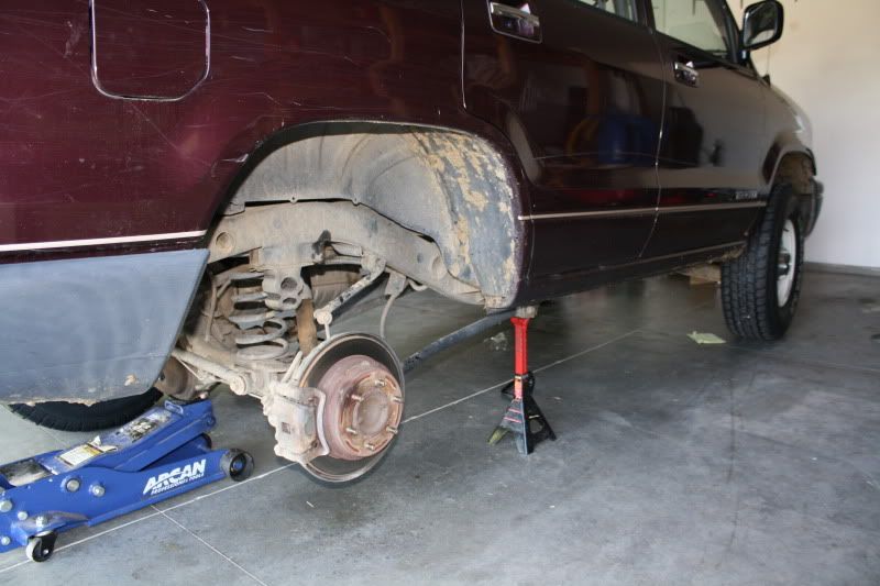

I started by removing the rear wheels and jacking the rear of the vehicle as high as I could get it. I put jack stands under the link mounts (seemed like the best place?). I have smallish jackstands that had to be raised as far as they go. I didn't feel comfortable getting under the truck with these, so I put 2 more under the truck and always used the jack as a safety.

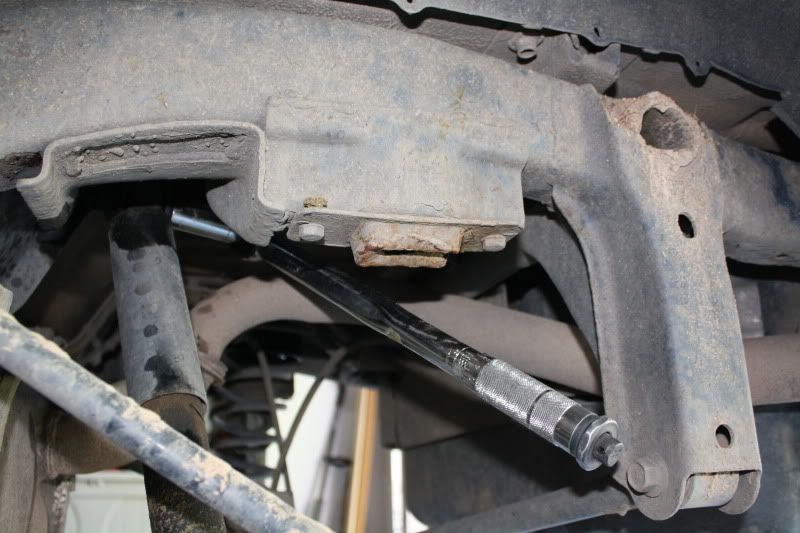

Removing the shocks took up about 80% of the total project. These bolts were TOUGH. I had soaked everything down with PB Blaster before starting, and probably should have done so a day earlier. I also soaked the T-bar bolts while I was at it.
I have an old broken torque wrench I use as a breaker. Using this, and all the strength I could muster, I finally got the bolts to move. I was VERY concerned that I might damage a shock mount or shear a bolt.

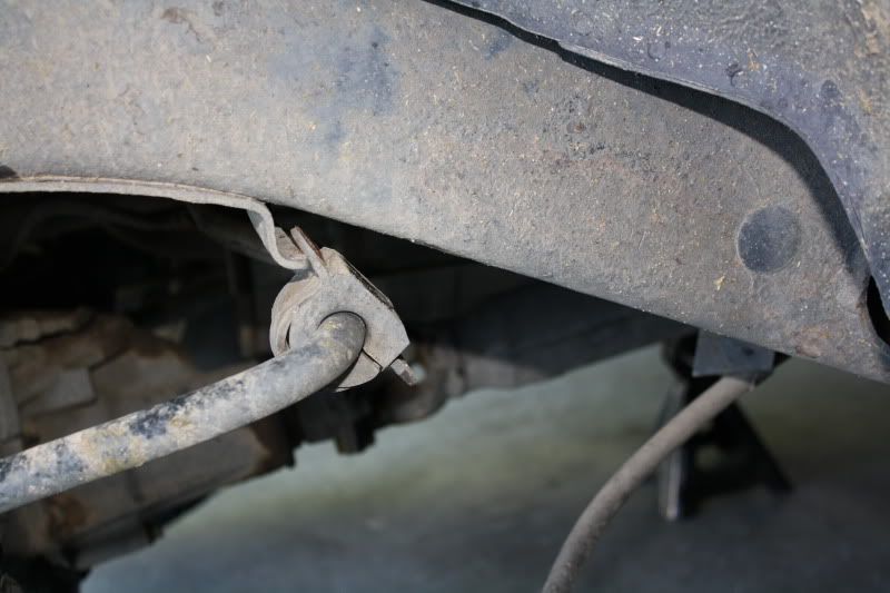

I have read elsewhere that you don't have to remove the sway bar link to get the necessary clearance for the spring, but I felt it would probably help in the long run. I worked on the link for a while and couldn't budge it. I feft I might round the bolt so I gave up. I decided instead to remove the mounts where the sway bar connects to the frame. This was super-easy and took a minute.

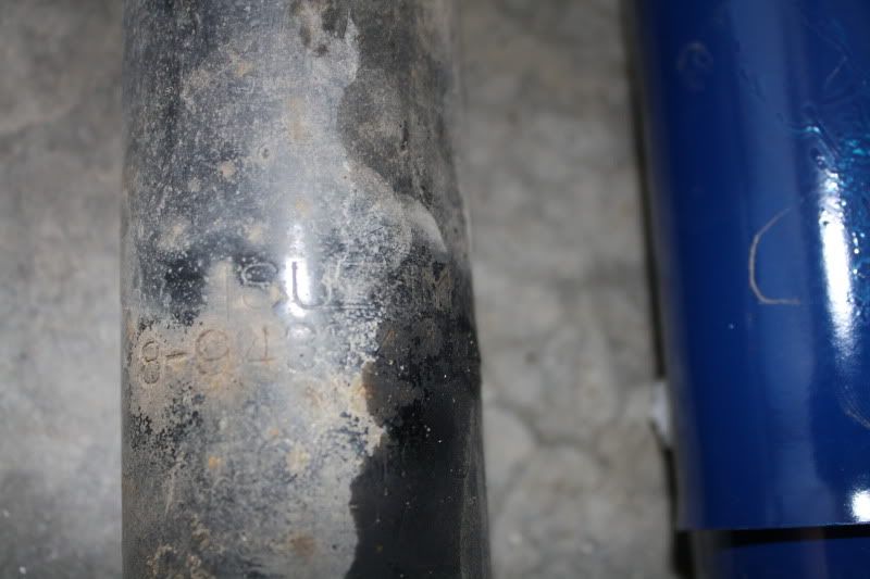

Once the sway bar and shocks were off, I was ready to swap the coils. I made another interesting discovery. My old, antique shocks has "ISUZU" stamped on them. Could these be the original 1993 shocks? I could compress them in and out easily by hand with no resistance. These things were GONE.

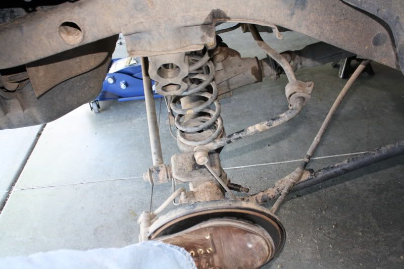

I did not remove the center link or panhard rod. In order to create enough space for the coils to drop out, I had to use my foot and push down hard to create more room. I also noticed that if I jacked up the other side slightly, it created a little more room.

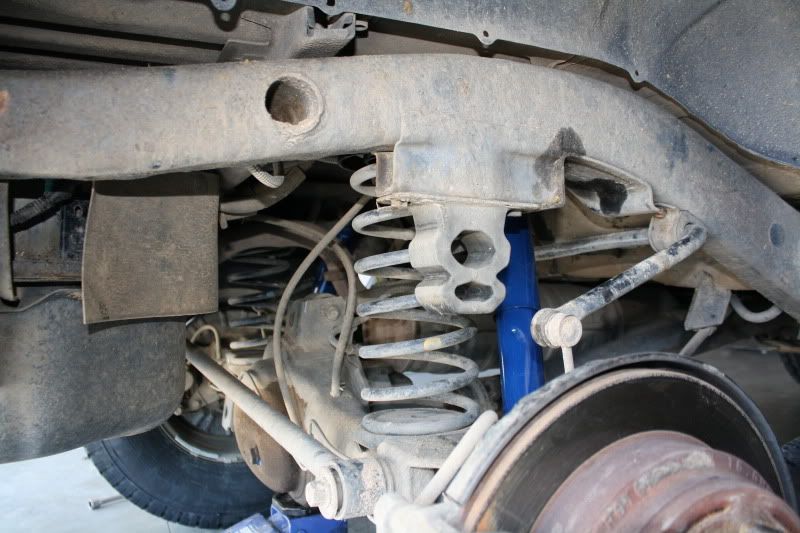

With pressure applied, the springs fell out. The Daystar spacers go on the top. The bottom mount for the coil spring has an indent, so it's impossible to get the top/bottom mixed up. With the spacers in place, the springs went back in. I had to bang them around a little to make sure they were seated correctly.

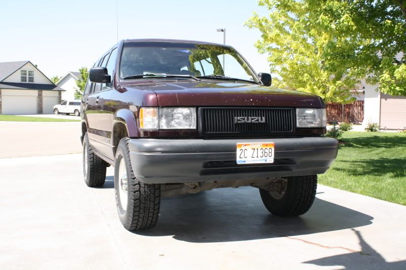

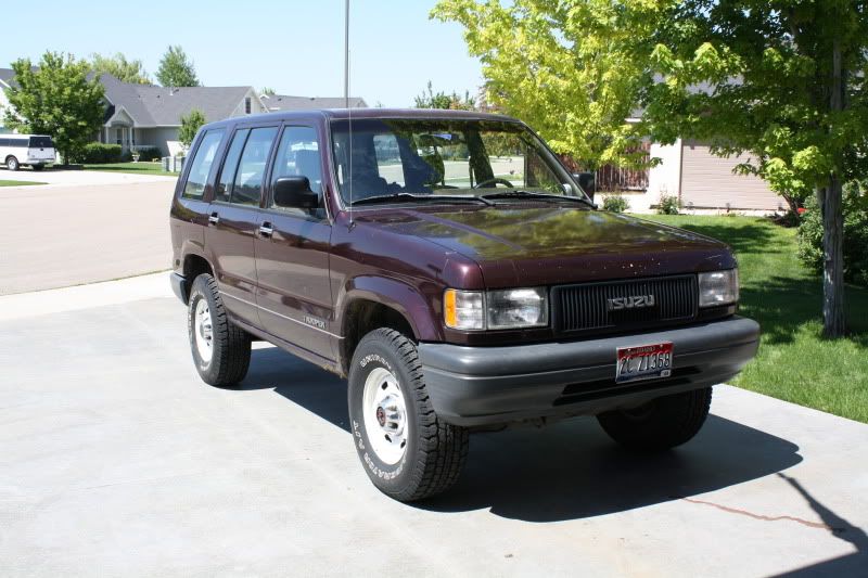

Done! I just realized that I forgot to take my "before stance" picture! My tires are 265/75/16, which add about 1/2" of lift. All together, it's about 2 inches above stock. With this size tire, I think it's absolutely perfect.
Here's the final result:
