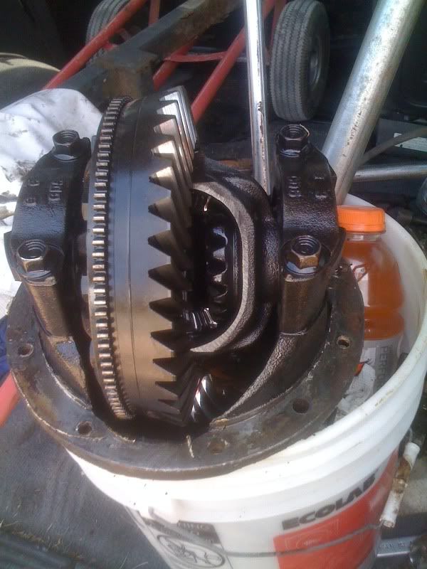

I just pulled this from a 95 trooper Ls... My question is this rear diff open or lsd.. Can you tell by the photo... I want to make sure I use additve if it is LSd.... I think I read somewhere on forum that the black on the gears is the additive... I am Thankful for any responce..

Open

THAT IS AN OPEN DIFF WITH REAR ANTI LOCK BRAKES , WILL WORK OK IN THE LS 95 WHICH SHOULD BE 4WHEEL ANTI LOCK, 4WHEEL ANTI LOCK DOESNT HAVE THAT TONE RING ON THEM , OTHER THAN NOT BEING LSD IT WILL WORK OK JERRY

Thank You!!!!
