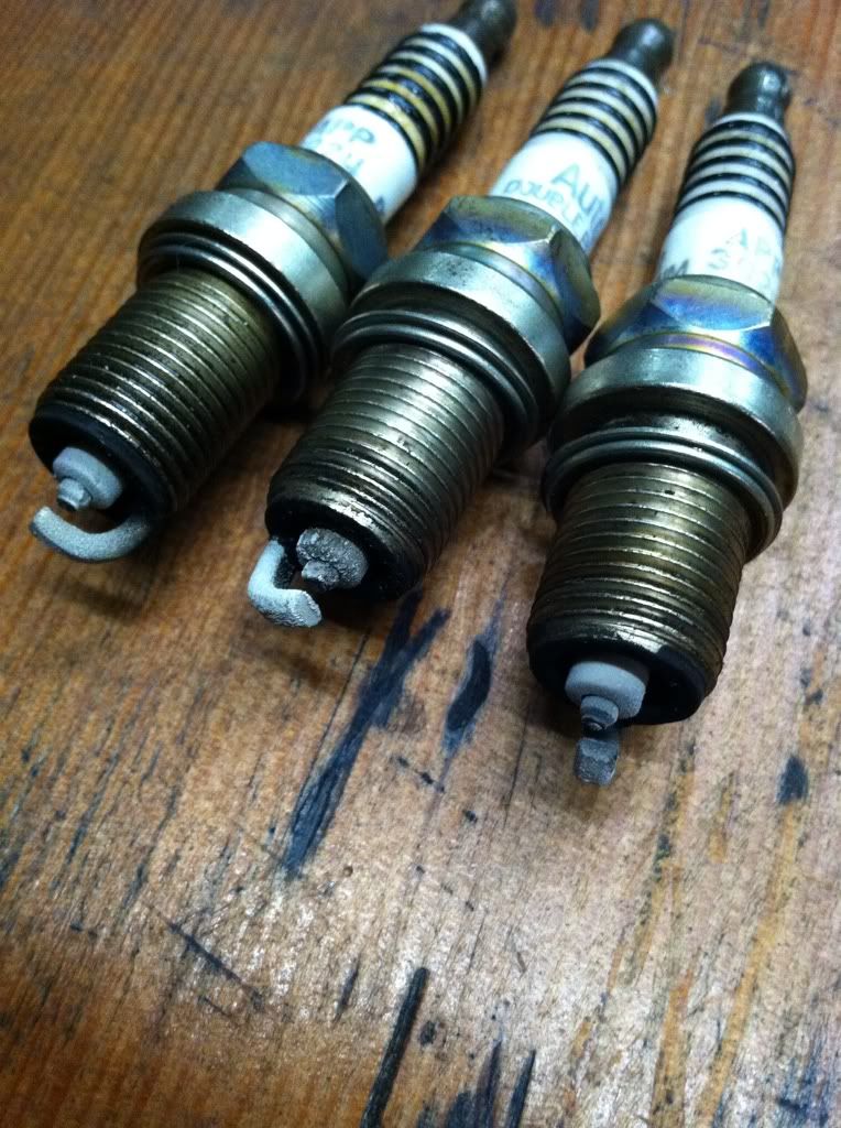

I can't remember what everyone suggested... I'm getting random miss fires with these... Yesterday it missed really bad on the freeway kinda freeked me out.. The middle one has a bit more build up on it... The auto parts store has some NGK's...

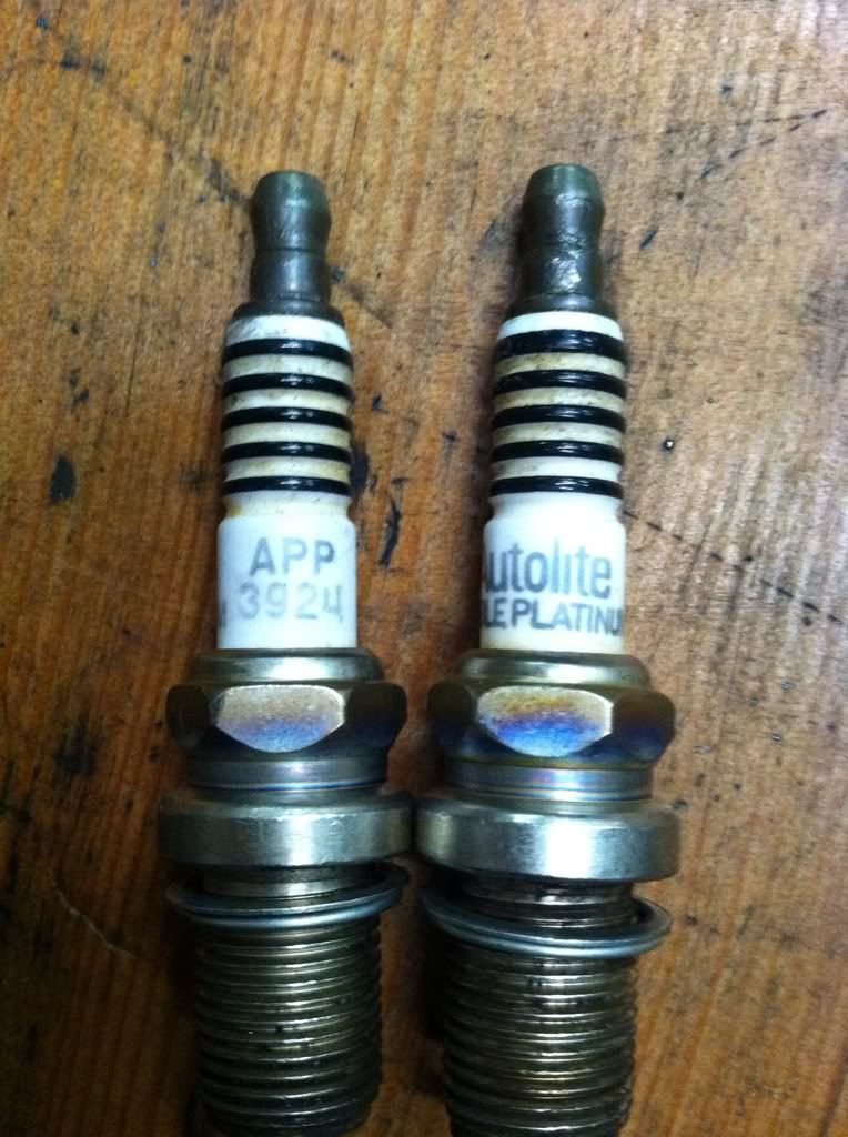

Still a platinum but with a different style electrode... Hopefully these will run better and stop throwing codes to...!!

Not sure I think the six plugs where $26... I could tell it was better as soon as I left my work... Traffic sucked so I couldn't really get on it but what little I did it was a big difference.. I should have tested the ohm's between the two brands.. The isuzu's must not like those autolites at all...!! I wonder if my gas miliage will get any better lol...

Your old plugs were looking a bit sad.
13,615 Posts
They had 20 thou on them is all... But very obvious now that isuzu's do not like autolites one bit... So far no ECM light !!! :)

I have been using Autolite AP3924 plugs in my 01 Ironman Rodeo and my 02 Rodeo with Ion Sensing Ignition system for at least 3 years and have had no issues with them at all. My other Rodeo has Denso plugs and there is no difference in performance between any of these vehicles, so in my opinion a 2 dollar Autolite plug works as well as a 10 dollar plug.
