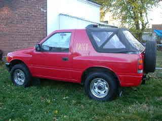

94 amigo 2wd 5spd i bought it for 350.00 and was running on 2 cylinders. Fixed the head gasket and it runs like a champ. But now i have problems starting it. It would start up fine and when i try to start it after driving it would just crank. But i did manage to get it to start when i pulled it home one time, i threw it gear and it started. Weird! I took the fuel pump out and hooked it up with a battery and it functions correctly and i have voltage at the harness underneath the car too. i switched relays between the horn and fuel pump and still nothing. just cranks the whole time and i do have spark. i searched and people with this same problem and had it fixed with a new alternator. i dont wanna spend money on a new alternator if it isnt the right fix. any advice would be greatly appreciated

got it running after i wacked the fuel tank with a 2x4. :lol:
i plan on selling it after i change the fuel pump. what do you guys think i could get for her? it runs superb but the bad part is that it has 194xxx miles on it and it needs a new top.
94 5 speed
2 wheel drive
new head gasket
no rust/straight body
thanks
