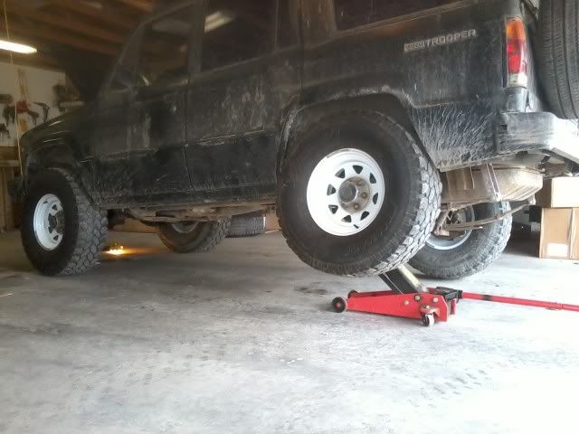

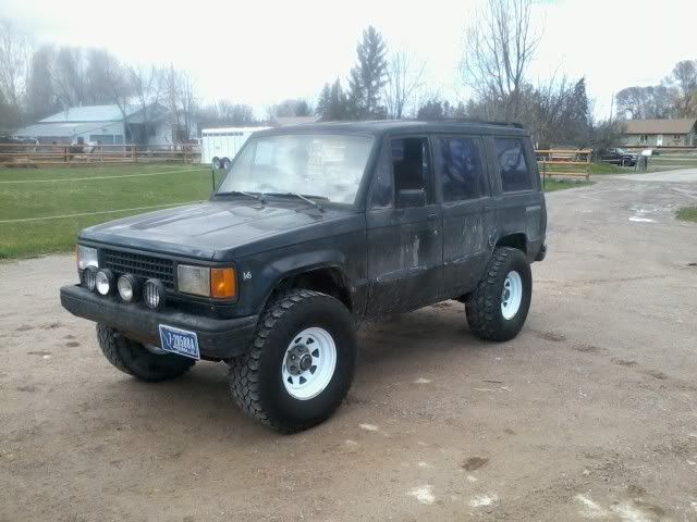

about a month ago i traded a nissan 200sx for this truck. i wanted to buy something to take to moyie springs idaho and thrash for the weekend. when i got it i had very little knowledge about troopers other than you could fit 33s with some fender trimming. i had some 35s in the shop and decided i could make them fit. i'm heading to idaho this weekend so this is my build so far.
when i got it:
how they fit the chevy wheels:

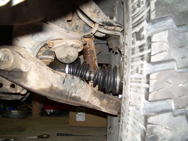

built a diff drop:
cv angle and new boots:

how it sits now:

Hoo boy the motor is going to struggle a bit with 35s but if you're not in a hurry that's OK...at least a 91 has the stronger axles than <87s.
That looks pretty sweet. Are you going to regear? Since you've got the V6 you could also swap in the 3.4L camaro engine for that extra oompf to help you turn those big tires. Nice trooper. Welcome to the group.
