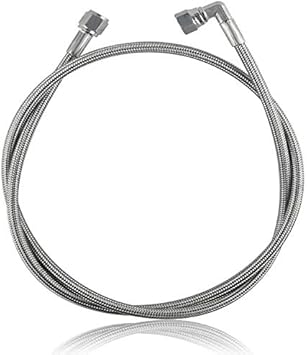

This is the line w the adapter needed I am using, I am gonna run it over the valve cover to the top of the turbo since the there is no "outlet" oil source on the driver side of the block

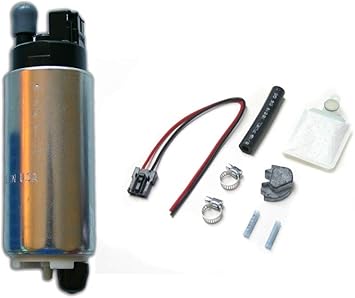

Installed the Walboro 255 in the tank fit right in the original cradle and came w everything you need. I would NOT however use the wire connectors they supplied, I have some heat shrink connectors w solder in the middle, use a heat gun and they are ready to tape up and go. And yes I cut a hole in the floor of the Trooper to get to the tank, and no I dont regret it.

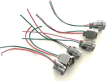

Wired up the injectors to the harness, pretty straight forward except one thing, the wiring on my harness in some places was BRITTLE, be careful or you will have a mess on your hands, you can also see the heat solder connectors I used, I have used them for years on all kinds of auto wiring project and they work like a dream, you just need a heat gun.
