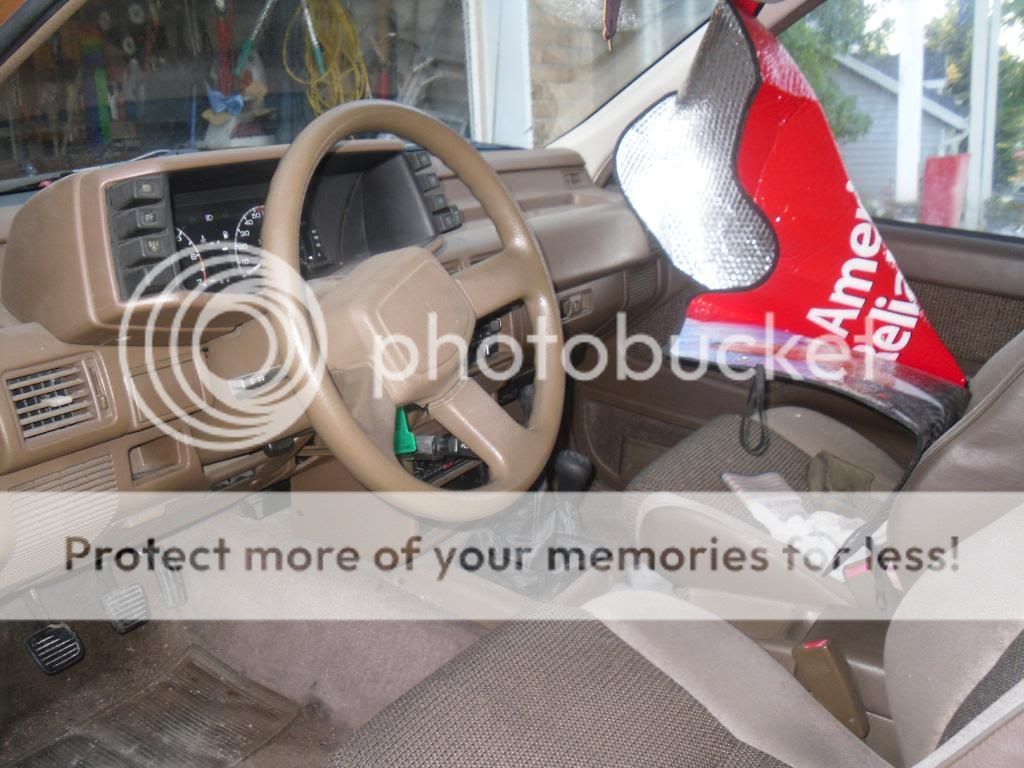

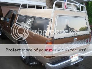

Earlier in the spring I bought an 89 Spacecab 4X4 from another member in LaGrande Oregon. Since then I have been picking up pieces here and there and junking out my old 88 Trooper. Had to make room. Well it's now running and some folks have been bugging me (nicely) to get some pictures up. I have been having some trouble doing the picture thing. I cannot seem to update my sig pictures and info. So here is my attempt to start a thread of the Pup. To date I have picked up the Pup, let it sit, drag it into the garage, pulled down the top end, found a blown head gasket and burned valve, installed a low milage AMC head, stole the tires and wheels from the Trooper temporarly, and ran it through the hills. It ran great and climbed great. My camara died so pictures are limited. Future plans are to install shackle and T bar lift, LSD in the rear, header and oversized exhaust, and fix the small amount of rust on the body. Overall I am thrilled with the truck, I have about 200 miles on it, the MPG is good (18MPG on old gas), the 4WD works great and it is comfortable. So here are some pictures I hope.

That's a nice truck, amazed at how well the graphics on the tailgate have held up. Not a fan of the camper shell though, but hey, its still nice.

The shell could be off in a matter of a few minutes, I like the covered storage. The little rack is really ugly, so I believe its a goner soon. The tailgate graphics are faded a bit, but still good. I like the Isuzu mud flaps. Still getting used to the little truck, had only driven Troopers in the past.

So I have been driving this thing every day now and I enjoy it more every day. I am through all the bad gas and so far the MPG is 18. Maybe the next tank will be better. Spent part of the last weekend shampooing the carpets and trying to get out the tiny rodent smell I keep smelling. To me it is amazing how the upholstry has held up! I have the lift shackles in the garage, might get them on next week. I came across a cruise control and I am wanting to get this installed also. I have been thinking I might get the header on and the 2.25 exhaust too. But I really like how quiet it is now and the power seems good, Have to think some more on that one. Getting older and a loud 4 banger might be annoying.

could you give me your steering wheel.... :D :D :D
I am interested to have it for my RS Trooper
I would give you the steering wheel if I came across a cooler one :D But the shipping would be......well higher than the highest mountain!
