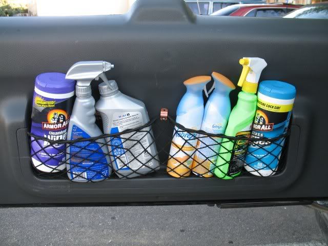

Wont work in 2nd gen rodeos. Unless you make a new panel for the rear door. Has a useless cargo net storage area there (much more usefull if you us a clamp to hold the net in the center). Otherwise I would have put my 6x9's in the door.

I took the rear door off because that was one of the original places I was going to mount them. The way the frame is run they would not be centered with each other, one in the middle of one side and the other wherever it fits. There's some wiring and the door mech but nothing that you could just cut a hole in the door and put a speaker there.
