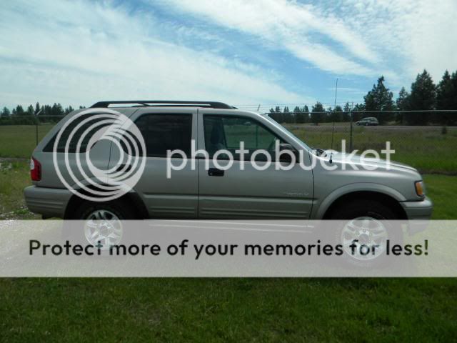

Flashback history - I Bought my bone stock 2004 Rodeo with the rocketship 3.5 direct injection engine 2 years ago and it looked like this in stock tire size and suspension.
It came home to replace the tired 180,000 mile old Honda Passport running a 3.2L, and 245/75/16 BFG A/T's
the 2004 had stock sized 245/70/16's on it with bare bones highway tread tires.
